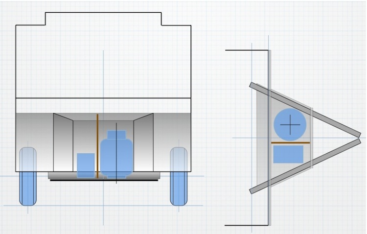

6" of clearance I would think would be fine if it was near the axle.
Ya know you could make a box with hinges on one side welded to the frame and bolt the other side up so it would swing down for easier removal.

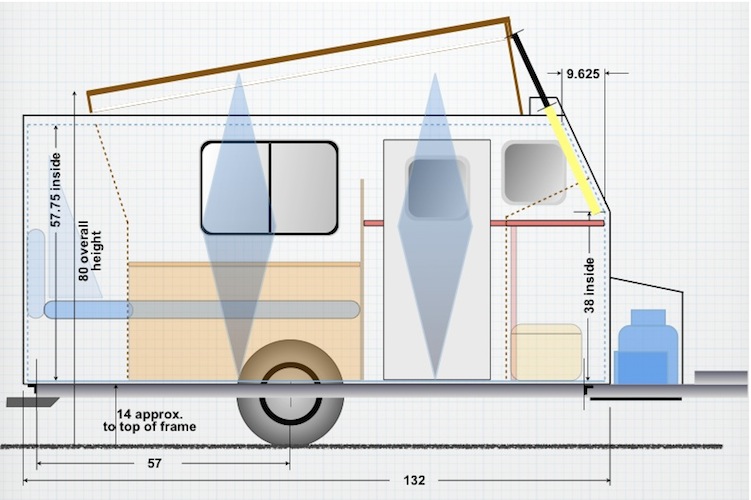

S. Heisley wrote:Regarding the battery, one thing that I haven't seen discussed here is where your charger or converter is going to reside. (Did I miss it?) That could make a difference as people normally want their battery to be near that.
It looks like you've got 37" from the front of the front body support/angle to the front of the frame. I've added 3" for the distance to the hitch ball so that gives a tongue length of 40". My feeling is that only the tongue strength matters - if it's strong enough there, it's strong enough everywhere else.
The area of doubt here is that I've said on the forum that I think teardrops can get away with frames only half as strong as the Australian trailer rules require, because teardrops are not abused like the utility trailers that the Aussie rules were written for. Now I guess that also applies to a trailer this size, but I'm not quite as sure as I am about teardrops (which can't have much extra weight added, because there isn't the space for it).
2"x2"x1/8" square tube on a 40" A-frame tongue gives a maximum trailer weight of 1560lb by the Aussie rules and so 3120lb for a 'teardrop'. So that looks just strong enough for the weight you are likely to get.
Going up to 3"x2"x1/8" rectangular tube increases the allowable weight to 2800lb by the full Aussie rules, so 5600lb for a 'teardrop'. That's clearly quite a bit more than this trailer is likely to be.
One intermediate step would be 3"x1.5"x1/8" rectangular tube which gives 2280lb by the Aussie rules, so 4560lb for a 'teardrop'. This is only 3.35 lb/ft weight (compared to 3.05 lb/ft for 2"x2"x1/8") so, as price seems to be based on weight, it's not a big jump in either weight or cost. Incidentally, I believe this is the section that Scamp trailers use nowadays for their 13ft trailer which is not a huge amount bigger than this and is lighter.
vtx1029 wrote:Personally I would look at how popups are done using ss cable and pullies, much cheaper and less things to go wrong IMO.
