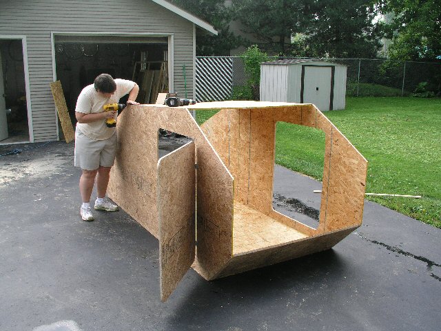

And yesterday when we built the weekender mockup Michelle overheated twice! So we took plenty of breaks...
Anyhow, you'll recognize this person... :shock: ...hard at work!!! :lol:

Steve Frederick wrote:Mike, I agree with the notion to use screws for the ply assembly. I used common drywall screws everywhere that the corosion potential is low. Elswhere, I used screws intended for decks or other exterior jobs. I pre-drilled every screw, added Gorilla Glue everywhere, and, was very carefull about placing the fasteners away from the edges of the ply.
I don't know how you would incorporate blocking into the design. I used blocking, incorporated into the insulation layer, to back up the joints.
Adding insulation would add a few hours to the project, and might make it a "three Weekender" :wink: . Worth it for us, we love camping in the fall when it is cooler, even early winter.
The project is sooooooo cooooooool I love the shape. Are the angles hard to assemble?
I've always used galvanized decking screws for my teardrops, but I would consider using the square head stainless screws mentioned eariler. Granted they are a little softer, and a little easier to strip out, but with the square head, I'll give them a chance!
As for blocking, yes, many of the joints could stand a little bit of blocking. Kinda like a stringer running across the width, under each joint.
And the insulation sounds good as well, but it would certainly turn the 1 day project into a multi day project. But I guess it's all in what you want. BTW, the angles were easy to work with. I was able to cut each one on the table saw, since none exceeded 45*.
And with each day that goes by I like the profile more and more!

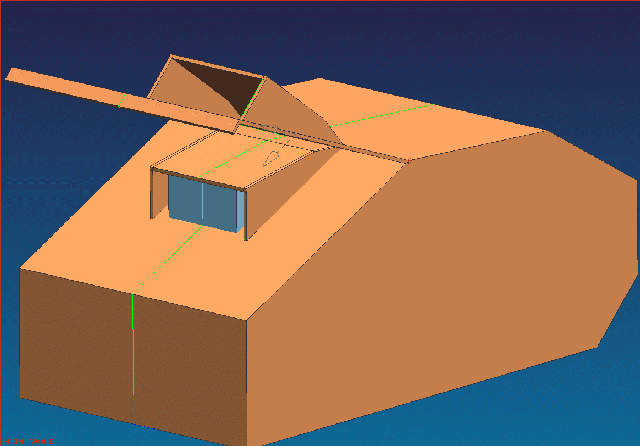

Where's the ac? Georgia summer 100+ need ac . I like the idea of ducts but i don't like having to lug the ac in and out of the car . could you build it in ,maybe in the top cabinet in the kitchen, or maybe a dormer that would look cool like the B-52. It'sjust noway you could get in it in the summer down here. And it can rain 2" in a litte time so i am uncomfortable with the AC seating on the ground under the trailer.
Hope this does not give too big of a headache. robert :wink:

Of course, if you don't want to spend the $419 on the roof a/c, you could always buy a cheap window unit, and put it in a box on the roof, like this.
The entire area under the box is open to the cabin, you you have access to the controls, as well as good air flow... :shock:
Postby mikeschn » Mon Aug 02, 2004 12:20 pm
Or, if you prefer, instead of building up and out, you could build down and in. You're losing a lot of space if you build inwards, both in the cabin and in the galley... but still, here's what it might look like...
Postby mikeschn » Mon Aug 02, 2004 12:33 pm
Last but not least, you could put a box in the roof, with a "window" towards the front of the trailer. Then just drop your a/c in, push it through the window and you're in business.
Of course you'd have to find a way to get the water out of the box. Something like a drain hose would do the trick. You wouldn't even have to cover the box. Just leave it open so that the hot air can escape! 8)

Mike ,,suggestion,,put a flap the size of ya a/c in the front, upper sloped area,,at camp lower flap to horizintal and set a/c from inside tear to the shelf,,,I dont know if ya got enough room vertically but its just a thought,,,
thought #2 mount a/c in roof on a teliscopisc setup ,, when traveling the a/c folds into the cabin via a hinge on the front edge of the panel,,flush mounted to the roof,,at camp,,from inside push a/c up and lock into position,, sort of a pop up a/c ,,

And if you tweak the body profile a little bit, you can use 1 long hurricane hinge on the galley hatch again! This is the approach I would probably try first.
Postby mikeschn » Mon Aug 02, 2004 3:54 pm
Here's another one. I like this the best so far.

Errrr, why not stick the AC on the front slope? Presumably you'd have to fit a cover for transport to stop the bugs getting blasted in. But it would get it (mostly) out of the way but accessible.
