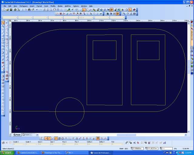

Postby mikeschn » Tue Jan 08, 2008 5:46 pm
Okay, here's food for thought...
bump the front out a bit, and make the door the same size as the other one...
You'll have plenty of space in your bathroom... ;)
Postby TheDuke » Tue Jan 08, 2008 7:24 pm
Lemme scratch around with that for awhile.

Postby TheDuke » Wed Jan 09, 2008 1:05 am
OK. Done scratchin around. Actually, I like the results, but I did it a little differently, Mike. I expanded the loo by moving the cabin wall back. I found the mattress was a little longer than needed, so I reduced it to 72". For a guy 5'-7", that's no problem. Measured a mattress I sleep on a lot, and it's 72", so I figure it will work. So the standing room (leg room) in the loo is now 24", and above the counter it's 34". Following your suggestion, I then made both doors the same width, and then nicked off the corner of the counter, and it seems to work OK. All outside dimensions stayed the same, except for the loo door. I put three revised drawings in the Album. I think I will go with it. Thanks for the good input.

Postby TheDuke » Wed Jan 09, 2008 1:45 am
Mike:
I tried a variation to make the doors a little more like the Cabin Car. It's not quite the same thing, but I think it looks better. I could change the trim to give it a woodie look. Hmm, Might try that.
