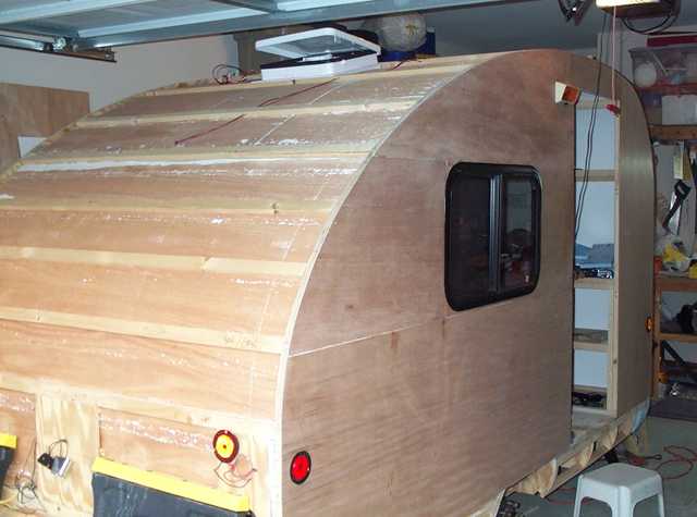

Postby LesterS » Sat Aug 09, 2008 9:00 pm
I have managed to make a bit more progress despite my travelling. Compound that with the fact that when I'm home the temperatures have been in the upper 90's. (It makes for slow progress)
I have started skinning the outside.
The current state of the Nest'r...

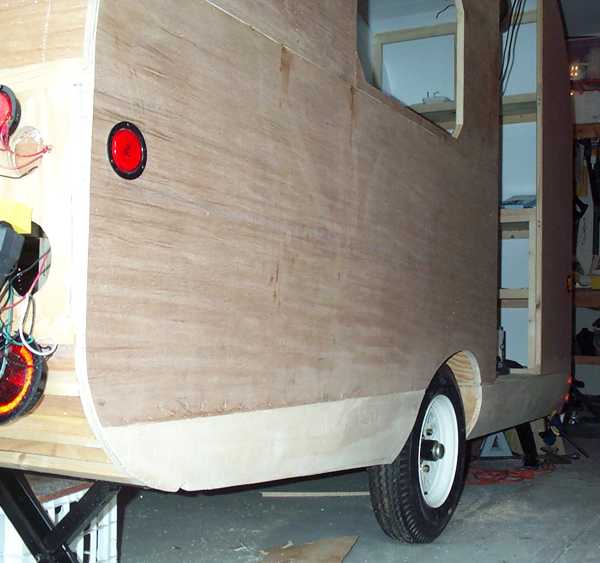

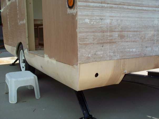

Postby LesterS » Sun Aug 10, 2008 5:53 pm
I thought I'd post one more picture here before I start back to my travels again -- This fall I should be able to get back to work on it more.
Here's the Nest'r with the rolled side rocker panels finally skinned.
To get the curve in the small pieces, I wet them down with water (both sides), then bungeed them around my front porch column until they dried. It gave them enough curve that I could get them glued on and nailed in place without much fuss.
Well, that's one side down!

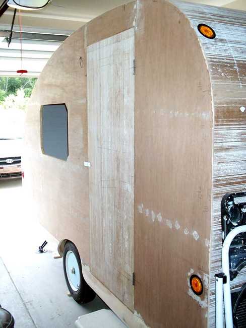

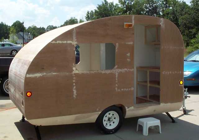

Postby LesterS » Mon Jun 01, 2009 9:10 pm
Well, I didn't actually fall off the planet, just was bizzy, bizzy. But now, I'm back on teardrop time. (Or in this case TTT-Time).
I've finally got the whole carcass skinned. Sanding ALL the styrofoam insulation made for one helluva mess. But the end result for only being skinned inside and out with just 1/8" thick material, it's pretty solid.
I tested all the wiring again - making sure I hadn't driven a brad through a wire somewhere - and all is well. My el-cheapo ancient 3amp battery charger reads 5amps with all the interior lights and the Fantastic Vent running on high. I dunno how accurate this really is, since I get over 4.5amps when I tested all the running lights.
Now I have to build the door and order some finishing materials.
I have been toying with the idea of either CPES, or thinning some Epoxy myself. I wish there was an easier method, but since the whole thing is really nothing but cheap luan, it'll need some substantial sealing. I'll be be ordering something before the week's end, so I'm imposing a deadline on my decision.
Anyway, without further ado... the Pix:
And there's more in the Album of course! :D
