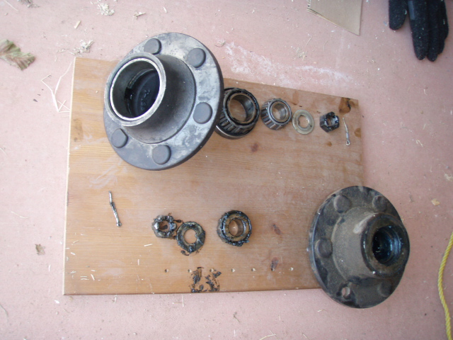

Postby RogHodge » Sat Jun 27, 2009 12:28 pm
Okay I pulled a hub… Outer bearing came out easy, inner bearing?!?! I beat the crap out of the proper places- no wait… I applied pressure to the appropriate location in an amount that I calculated to provide sufficient motivation to unseat the inner ?race? to no avail.
Now what? I guess I could have the local trailer repair people repack the stuff for me. I hate to pay for work that I should be able to do myself.
Any thoughts?

Postby RogHodge » Sat Jun 27, 2009 3:10 pm
What about me?!?! What about my needs?!?
Well as it turns out if you apply enough pressure enough times things will change. Disassembly of one side complete- might try side #2. Pressing them back in might be a chore. I guess we’ll see. Side 1 looks good.
I don’t know if there is a way to NOT remove the seal to get to the inside bearing. I might never do this again…*Now with photo!*
The cleaner hub shows the inner race pushed out a bit which allowed the bearing to come out. Most thoughts about what to look for or how to proceed are appreciated.

Postby chorizon » Sun Jun 28, 2009 11:29 am
RogHodge wrote: Pressing them back in might be a chore...
Yeah, you have to "remove & replace" the seal to get at the inner bearing. A seal driver set would make the installation infinitely easier.
The new races are trickier. You'll need some sort of "arbor" to allow you to press the race back in. Once again, the seal driver would be an OK choice for this. Here's the tricky part. Put the races in the freezer for an hour or so, you'll want them to be as cold as possible. Clamp the hub in a vise and apply heat with a propane torch to the portion of the hub where the race will go. Get it good and hot. Now...run to the freezer and grab the race (preferably with some pliers, don't let them get warm)...now run back and...hopefully drive it in with no problems. The window of opportunity is pretty short so do it quickly. Good luck!

Postby Nitetimes » Sun Jun 28, 2009 11:37 am
RogHodge wrote:What about me?!?! What about my needs?!?
Image[/img]
I'm kinda at a loss as to why you would have to force the race out to get the bearing out??? If that were the case you have a serious issue.
In pondering it I think the reason you worked at it so hard is that you used the race to push the seal out????
You want to find something that will just fit thru the hub (a wood dowel or even a square piece of 2x2 trimmed down to fit) from the front side and stuff it in there and pop it with a hammer a few times...the bearing will drive the seal out and fall out without any interaction with the race.
