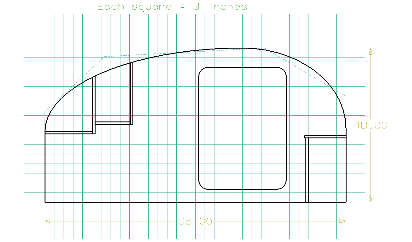

Postby mikeschn » Tue Aug 10, 2004 7:20 am
RC wrote:Hey Mike,
Do you think you could rescale your weekender into a 4X8 configuration? I would be looking at having a sleeping space that could handle a 6'3" person. The more I look at your plan, the more I like it, but don't want to go to a 10 ft size.
Hey RC,
You give up a lot when you give up those last 2 feet, or that last 1 1/2 feet. I've stretched the basic weekender to a 4x8 profile. I kept the queen sized bed length, 80" so that you have room to sleep. But in doing so, I have to give up the under counter storage for the galley.
I also had to remove the front and rear radii at the bottom, so that it would still fit on an 8' trailer.
I also managed to add a small cabinet above your feet for cabin storage, plus you still have the inside cabin chest at the front of the teardrop.
Only you can decide if you like that. I prefer to have the extra 1 1/2 feet, and still have it sitting on an 8' trailer.

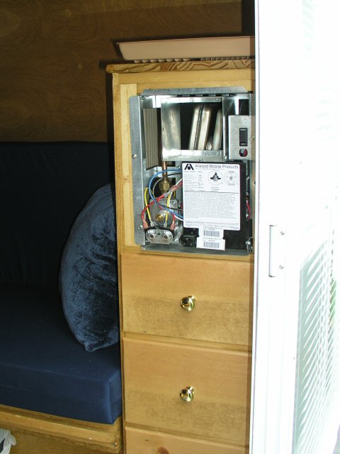

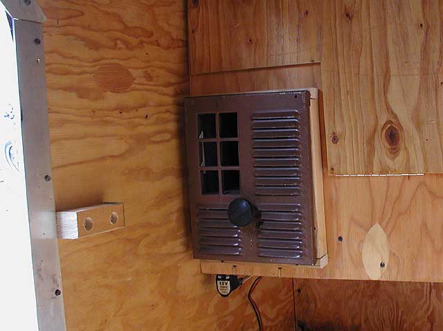

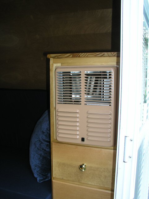

Heating, yes very important. You want to use a forced air propane furnace. There are two styles... I'll dig up the URL's after dinner.
The best place for a heater is in one of your cabinets above your feet.
I'll have more information for you later... The grill is calling!!!
P.S. Those scraps of OSB are in the shed again, and I'm thinking maybe I should mockup the back end of the Winter warrior one of these days. It should only take 1 morning... :D
Postby mikeschn » Mon Aug 16, 2004 5:50 pm
Okay Carl,
Let's talk about the heater... I think the best way to heat a teardrop is with the Atwood Propane forced air furnace. The toxic fumes are exhausted to the outside, and the clean heat is spread evenly through the inside.
I have one in my Baja Benroy...
And Q has one in his Teardrop too.
Q's method lends itself very well to the weekender. That's what I have planned, even if my other half doesn't know it yet!!!

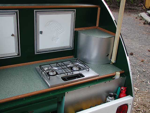

Postby Guest » Mon Aug 16, 2004 6:22 pm
That's a nice looking galley. Where can we see more pics?
