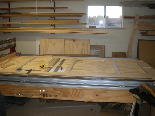

I made a little sawdust today, cutting out the framing pieces for the left side. I laid them out over my drawing to check for fit and accuracy. Before I glue this up, I need to stitch an extension piece to the plywood to get my 10 foot length. I'm going to join under the frame piece for the aft bulkhead, so it can back up the joint. then I'll have to add about 3 feet on that to get to 10 feet.
Getting ready to make router dust takes a lot of attention and detail so you can get everything done in one setup. I've spent the last couple of days reviewing and revising my drawing. I'll put up the latest version DXF after I get the first side done.

After I do a little router work to get to ten feet, I'll glue the framing to the outside ply, let that dry, Wire & insulate, then glue the interior oak veneer ply, then rout. I will intentionally position framing members such that they get routed for dimensional accuracy where it counts. That way I can slop in the framing (say, within a half inch) and achieve good accuracy later. The wall assembly should come off the router ready for outside skin and interior wood finish and it's ready to mount. At that point, the Tear should assemble quite quickly, with precise mounting points for anything structural. This will leave only minor finishing stuff. (famous last words)
If this was clear as mud, all will be revealed as progress progresses.
