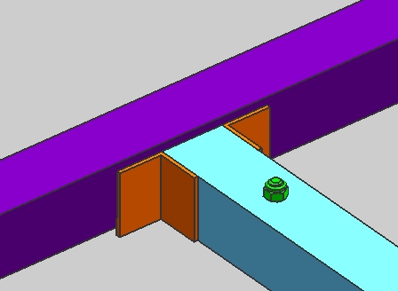

You guys talking about my orange brackets? :? Gage, back me up here... orange is kewl!
I haven't shown the bolts yet, but if the axle doesn't flex, then 1 bolt across the tongue and 2 bolts thru the axle...
Andrew brought up a good question... how far in does the rubber go? anyone know?

Mike! If you bolt through the axel you will weaken the axel. All the stress is at that point where the tongue meets the axel. How about two-piece V tong? Bolted to the axel under the outside walls. You will have less stress on the tongue too. You have a triangle, which is much stronger and you can go with thinner material. :thinking:

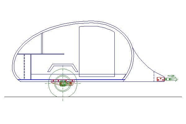

Guy wrote:When you consider your tongue take a look at the possibility of including a tongue box as part of the structure.
That's pretty much exactly what I've been doing, except the 'tongue box' is all there is. Here's the profile so far:

I would hope that the Ultralight might actually be stronger than other tears, not weaker. The true measure of suspension strength is more like a strength-to-weight ratio and the reduction in the weight of the Ultralight is a big benefit. Building heavy is not necessarily building strong, because the extra weight puts extra load on the structure.

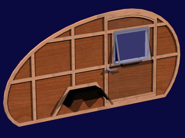

Guy wrote:Whilst I am at it, I wish to add that besides shifting the paradigm from House building we might also consider changing the notion that woody details are merely decoration appliedto the exterior. They should be thought of as more integral to the structural design, sort of , the framing on the outside.
I understand. The one thing is that with woody framing, you are limited to what looks OK and it tends to have to be the same all over - if I want just 2 or 3 vertical frames and some 1x4s above and below the door, and no other framing, it's going to look awful if done on the 'woody side'.

mikeschn wrote:Andrew brought up a good question... how far in does the rubber go? anyone know?
No where near the centre. To get an idea look how short the non axle units are.
If you were afraid to drill a hole in the axle (a valid fear imo) you could weld a T on the end of the draw bar and then U bolt the draw bar to the axle. You'd need to make allowance in the torsion box for the ubolts.

Postby Chuck Craven » Thu Feb 23, 2006 9:16 pm
Mitheral
That is not good either. The problem is the axel has positive, negative and radial stress all at one point half way down the axel. The axel can amplify that stress point. Two positives or two negative stress points (the wheels) will add to each other at that connection point. The better approach is to have two drawbars mounted near the wheels at an angle to the stress points going to the hitch. This spreads out any stresses over a larger area negating any single stress point. There is a physics law for that (can’t remember the name). Look at a Beehive there is no single wall perpendicular to another always at an angle. The Beehive is very strong for the material it is made of “Bee paper, chewed up plant fiber/ pulp and Bee spit”. Same with a teardrop the roof is at an >90 angel to the floor. A curved surface is always stronger than an equal flat surface. I would think that most failures of a teardrop trailer will be where the walls meet the floor, or an under designed tow bar / hitch. :cry:

Postby Mitheral » Thu Feb 23, 2006 10:54 pm
Chuck Craven wrote:Mitheral
O
| > Put Put
O
Chuck
Agree totally, I think we're talking about the same thing when I talked about an A-Frame:
Mitheral wrote:An A-frame under the torsion box frame connecting the hitch to the axles might be better. Use angle rather than square tubing to reduce mass and the torsion box floor can be bolted to the A-Frame all along it. An additional piece under the front edge of the floor (sort of like the horisontal bar in the A) would allow you to pick up the heavy load of the front wall in a distributed way. A person wouldn't have to go overboard on the angle, even some 1 1/5 sould be sufficient.

Postby angib » Fri Feb 24, 2006 10:01 am
I'm in favour of the A-frame idea too. The single tongue has the problem that it connects to a 'hard point' at the front of the floor, where it is supported by the body front, but at the back it is connected to the middle of the floor - like putting a pillar on a trampoline! The A-frame will pick up the same hard point(s) at the front wall and ideally the other end will meet the body sides. Rock solid.
The downside of the A-frame is that, although it has as much sideways strength as you could want, the vertical strength will be less than a single tongue - two separate bars/tubes/angles never have the same bending strength as one bigger bar/tube/angle. But this isn't a big deal, it just means the tongue has to be a bit heavier.

I figure the walls could be built up like this. You could build them right on your work bench, in the comfort of your heated workshop... 8)

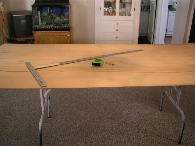

Postby mikeschn » Fri Feb 24, 2006 12:24 pm
If anyone would like to layout the outside profile on a piece of plywood, here are the x,y points...
Ultralight
x, y
6.79, 0
3.27, 3
1.35, 6
0.32, 9
0, 12
0.22, 15
.89, 18
2.03, 21
3.66, 24
5.82, 27
8.57, 30
12.01, 33
16.29, 36
21.67, 39
24, 40.10
27, 41.37
30, 42.5
33, 43.5
36, 44.37
39, 45.13
42, 45.81
45, 46.38
48, 46.86
51, 47.25
54, 47.56
57, 47.78
60, 47.93
63, 48
66, 47.95
69, 47.67
72, 47.14
75, 46.35
78, 45.27
81, 43.875
84, 42.08
87, 39.77
90.61, 36
92.66, 33
94.17, 30
95.2, 27
95.8, 24
96, 21
95.85, 18
95.4, 15
94.6, 12
93.5, 9
91.98, 6
90, 3
87.42, 0
I'm laying out the points myself right now, so I'll let you know how it works out...
Postby angib » Fri Feb 24, 2006 2:07 pm
Mitheral wrote:No where near the centre. To get an idea look how short the non axle units are.
I think the suspension pivots and rubber rods may be longer in full axles, but this photo of a Henschen axle certainly suggest they don't get anywhere near the middle:
I think your U-bolt idea is perfect, as long as the clearance above the axle tube is sufficient.
Chuck, I'm not in the least worried about the load on the axle tube. Drilling any serious holes in it is another matter entirely - it's got to invalidate any warranty for a start.
