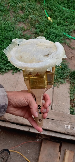

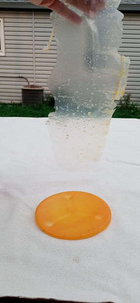

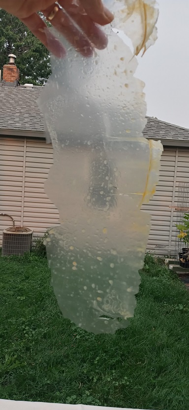

Pmullen503 wrote:Resin and glass isn't than much more expensive than PMF and is more waterproof.
I did the numbers on PMF over Fiberglassing just to see what the price difference really is. People always say that fiberglassing is just a little bit more than PMF so why not just Fiberglass. Well, there really is a reason it is called PMF.
Here are the numbers using the materials recommended earlier in this post for fiberglassing.
6 Yards 6oz x 60" Fiberglass $46.50
6 Yards 6oz x 50" Fiberglass $42.00
6 qt Kit Non-Blushing Epoxy $114.05
Total Before Shipping Costs and Tax $202.55
Here are the numbers for PMF.
15 Yards 60" 7 oz Cotton Duck $59.85
1 Gal Tight Bond II $26.99
Total Before Shipping Costs and Tax $86.84
I did not add in tax and shipping because that is a variable that might be mitigated by local resources. If you did however have to order in the materials the epoxy resin and fiberglass is 37.04 for shipping. I would suspect that is because it is a chemical. 15 yards of cotton duck cost 7.99 for shipping. Tight Bond II is available everywhere, so I did not include a shipping cost for it.
In this case the cost difference of PMF over fiberglassing is nearly 1/3 the cost. The larger the project the bigger the cost difference would be.
I have use fiberglass and I don't like working with it. Nothing about it is fun to me. PMF just works and it is simple to do. I always tell people, if you can hang wall paper you can PMF. You also don't have to worry about a possible reaction to it.
As far as fiberglass being more waterproof? I doubt it. Here are some pictures of TBII that I had thinned down to 50/50. 50/50 is my go to mix ratio for all my builds.

Now imagine TBII applied to the wood then canvas and then another coat of TBII. It is going to be watertight.
