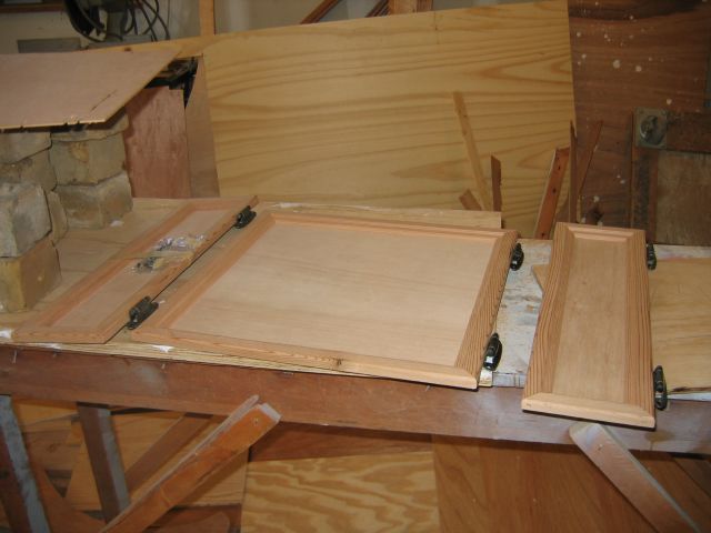

Cabinet doors made by my father in law. He sure does good work.

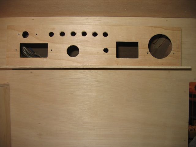

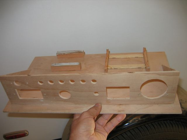

The power panel was built today. The face has been cut out for various switches, GFCI outlet, 15 amp shore power breaker, 20 vdc DVM to monitor trailer Battery Voltage, 30 Amp DC ammeter to monitor current draw off trailer battery, Cigarette lighter power plug.
Power panel test fitted.

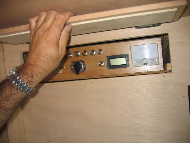

I got the power panel hardware installed now. I get into this stuff since I am a phone man.

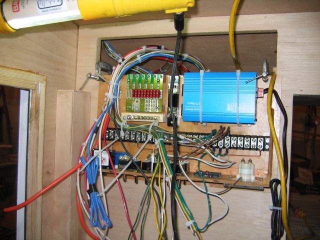

This evening the power panel connections has begun. The panel is temporarily hung on the cabinet facing with C clamps. The flouresent trouble light gives plenty of lighting. I did manage to get all the temporary signal lights/trailer chassis wiring reconnected.

ahhhhhhhhhh, a man and his zip ties...truly inspiring :D ;) :thumbsup: ...................................... 8)
Posts: 15128
Postby jplock » Wed Sep 06, 2006 10:17 pm
That's the way a phone man works!

jplock wrote:That's the way a phone man works!
Zip Ties ! I figured you would lace it in. :lol:
Sonetpro
Posts: 2038
Images: 107
Location: Plantersville, TX
Postby jplock » Thu Sep 07, 2006 6:12 pm
I thought of lacing it, but it is less trouble with tie wraps. Lacing is pretty though.
