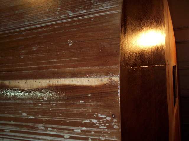

Finally -- I finally bought my epoxy and began the process of coating the Nest'r.
See?

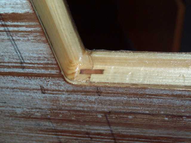

And I cut a window!
(The router cut even shows that I DID really biscuit darn near every joint!)
The coating will continue as long as I can keep the garage warm...

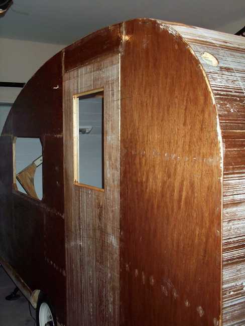

Well progress... progresses. Albeit what seems slowly.
I have finally given her a complete single coat of Epoxy, and only used HALF of my 1.5 gallon kit!
The seams are taped -- all except for the corners.

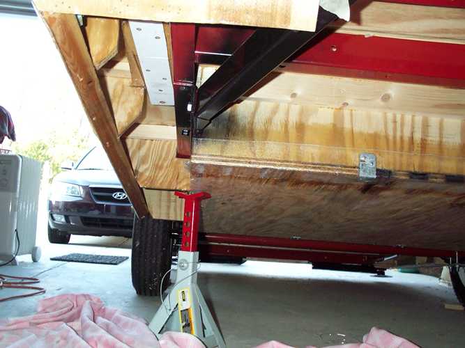

I started to do the drop box underneath too:
The floor of the dropped area is the only thick material of the whole build, the rest of the floor is 15/32" (.48") material, where this section is 23/32" (.72") thick. (The remaining 23/32" plywood was used to cut the curved sections of the frame.)
The drop box needs to be epoxied to take the beating the underside of the camper will undoubtedly take; rain, road debris, gravel, small animals, etc.
