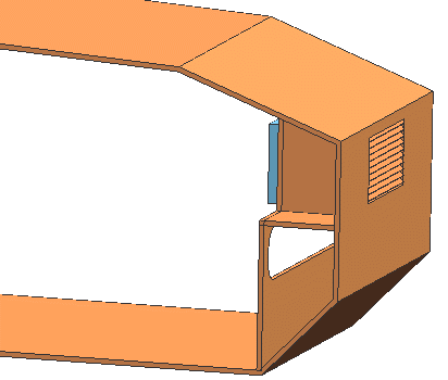

Hey Guys,
I have started the final drawings for the webpage... Just thought you'd like to see where the furnace ends up!!! :)

Postby mikeschn » Wed Aug 18, 2004 8:21 am
Here's a couple more air conditioner ideas...
Here's the front mount one. I've been avoiding the front mount because I don't want to increase the tongue weight, but for those of you who don't care about tongue weight, this is an option...
Postby mikeschn » Wed Aug 18, 2004 8:22 am
And here's another top mount a/c. This one is above the axle, but mostly out of the cabin area... plus the area in front of the a/c is almost 5', for those of you who want to "almost" stand in your teardrop or ttt.
