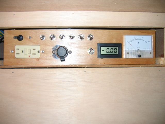

Nice raceway. Got any more pictures of it, or of the battery location under the floor?
Your control panel is awsome. I'll bet you could crank out a few of those and the folks here would buy them! :o

Boy isn't that the truth. JP that is awesome.

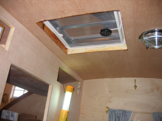

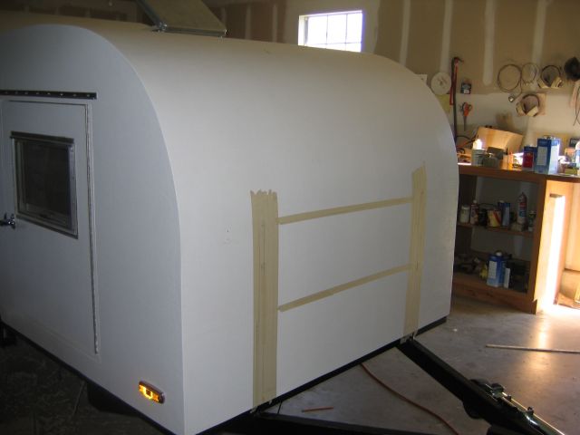

Postby jplock » Sat Sep 09, 2006 7:26 pm
Saturday's Work
The panel has been powered up and no smoke!
The roof vent is in place.

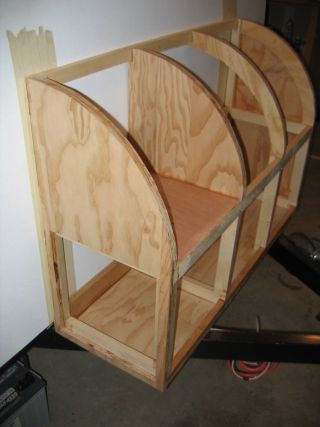

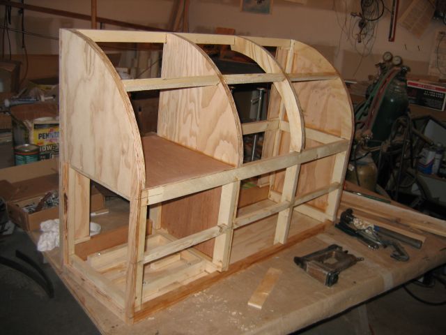

Postby jplock » Tue Sep 26, 2006 9:52 pm
Here is the progress on to the tounge box as of Tuesday 9-26-2006.
The smaller compartment on the bottom left is going to be the battery box.The top half will be the cut out into the trailer. I just don't want to cut it yet! :chicken: :chicken: :chicken:

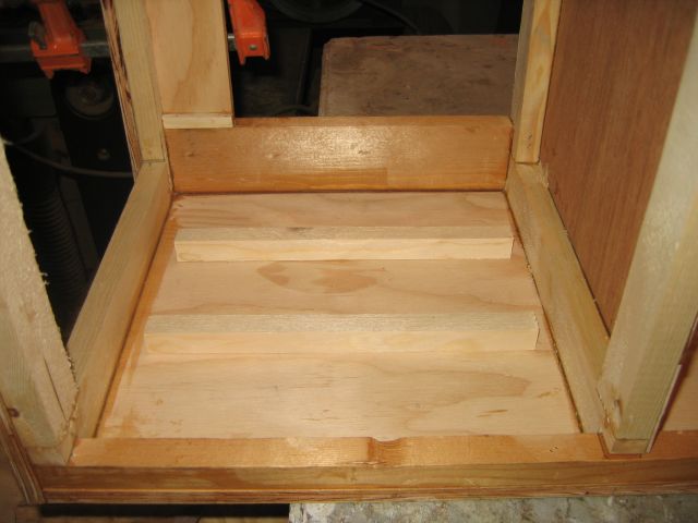

Here are a few more tongue box pictures.
Flanges for putting screws into wall studs. Around opening to be cut in wall.
Rail slides to aid in battery mounting. Aslo it will raise it off the floor a little.

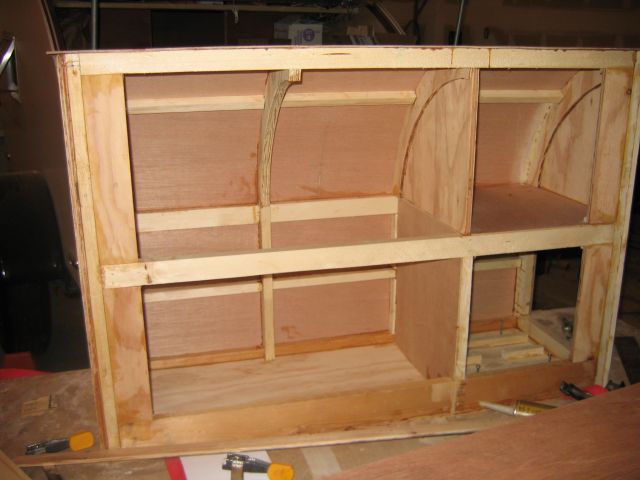

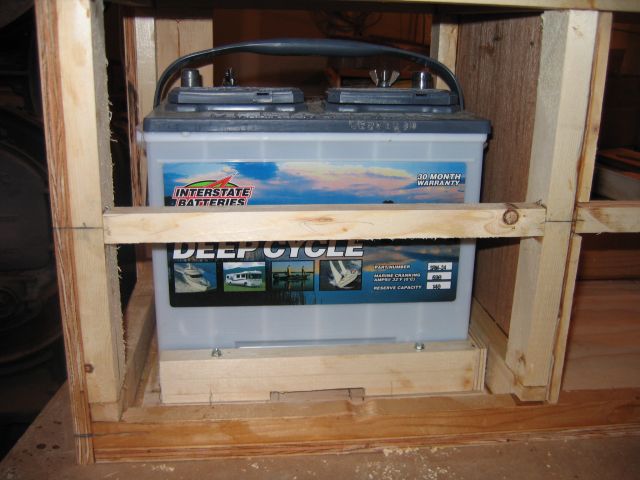

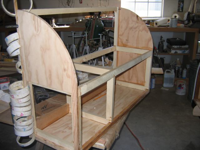

Postby jplock » Thu Sep 28, 2006 9:01 pm
Here is work done this evening Thursday 09-28-2006.
The framing is completed on box.
Battery stand-Off mount is made.
Battery is test fit in battery compartment.
The battery charger of choice. A test charge was done on the battery for 24 hours, and worked fine.
:hammer: :hammer: :hammer:

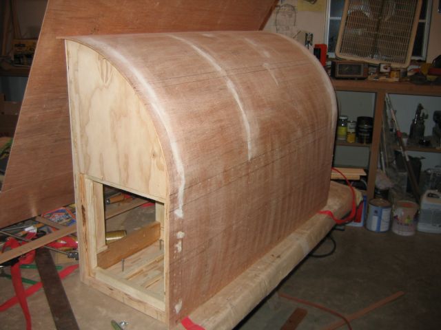

There have been setbacks on the tongue box. The first attempt at bending the luan was a disaster! I had all the ribs with a bead of panel adhesive, and I started bending it and using air nailer. At some point in the bending and nailing, the luan started popping loose leaving the luan hanging loose and ribs covered with adhesive and hundreds of nails. I worked frantically for an hour tearing off the luan and cleaning off adhesive before it set up. Then pulling out hundreds of nails (It seems). I failed to use the web straps that I used in covering the roof spars. I assumed this tongue box is small it will be easy! To my surprise it has been worse than the dreaded hatch, but I think I may be on the right track now though. Sometimes we need to be humbled, and I sure have been! Here is how it looks after the disaster, and urban renewal.
jplock
:cry: :cry: :cry:
The first layer of luan. (It reminds me of a 2 story dog house.)
The inside view.
Keep smiling!
