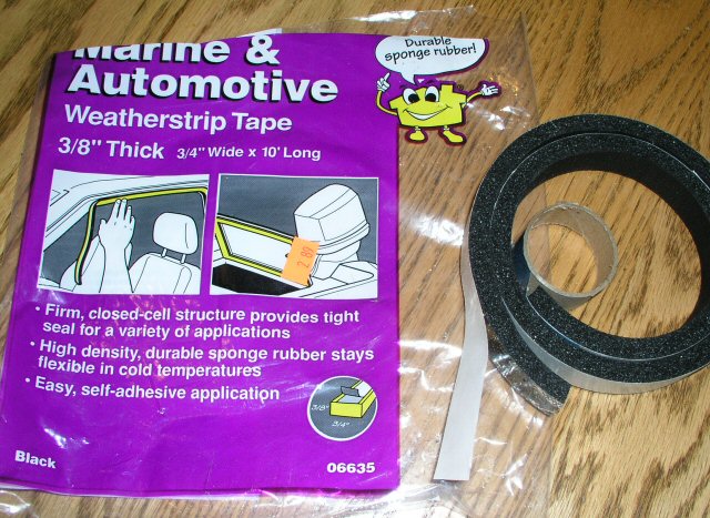

P.S. For the weather stripping, the heavy black stuff from home depot. I'll see if I can take a picture of it later...
Postby mikeschn » Sat Sep 04, 2004 6:18 am
Here's the weatherstrip I used on the Baja Benroy...
Seems to be working just fine!!!
Postby Arne » Sat Sep 04, 2004 6:55 am
Mike, where did you get it...?
I like the thickness.... but seems like it would not be available at pep boys, more like marine supply.
www.freewebs.com/aero-1
Arne
Mr. Subject Line
Posts: 5383
Images: 96
Location: Middletown, CT
Postby mikeschn » Sat Sep 04, 2004 8:28 am
I got that at Home Depot.
