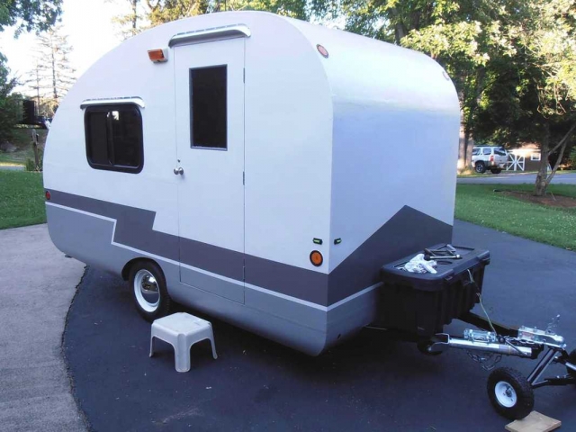

Postby LesterS » Sun Jul 06, 2014 7:13 pm
Final roll-out...

Re: Progress before post - that's the order.
Postby PKCSPT » Sun Jul 06, 2014 7:43 pm
I really like the color,,,

Postby LesterS » Sat Feb 10, 2018 7:25 pm
Dan,
I used a semi-gloss exterior grade latex house paint; two coats, over two coats of Zinsser Bulls eye 123 acrylic (water based) primer, over a thin coat of epoxy.
The primer went over the epoxy beautifully, and attached itself very well.
On the whole the paint held up very well.
But a white camper living outdoors does pickup stains!
Especially when the local song birds' diet includes purple poke berries.
Between the bird doo and the grunge from the maple trees; she got quiet dirty.
For the most part it washed off fairly well with car wash soap.
Now, I have learned that the epoxy alone is not really enough deterrent to fully protect from the effects of the environment.
OR -- I maybe didn't make the epoxy coat thick enough.
But there really needs to be a barrier that cannot crack when the underlying, material tries to change shape.
I have experienced some spots where the the luan has split or "checked".
The solution?
KEEP AFTER IT.
I usually just carve out the little split (they tend to be no more than and inch long), then re-epoxy; usually with a more robust coating and some filler when needed. Or epoxy AND fiberglass cloth for any stubborn spots.
For future reference...
I would definitely make the epoxy coat thicker or cover the whole build with glass cloth embedded in the epoxy.
But for paint?
No changes.
I would paint a boat that way... and just may. :)
I looked at your built thread. Nice work. :applause:
Since you have used the fiberglass cloth in your build, I don't foresee you running into to the same issues as I had above.
If you are trying to hide imperfections (aren't we all?) I would keep in mind the 10-foot rule.
If it looks good from 10 feet... it rules. :D
My latex paint didn't cover the imperfections, neither did it enhance them... it just painted over them!
Helpful masking hint (for those stripes) ...
1) Paint the whole base coat.
2) Let dry.
3) Mask for the stripes.
4) Paint the EDGES of the Tape where new cover will be going, but with the BASE COLOR.
- (The paint WILL bleed under the masking tape; so it should be the SAME color).
5) Let the "tape edge sealing coat" dry.
6) THEN you can paint the stripe color(s).
It will make for VERY sharp edges on your stripes. :thumbsup:
Keep buildin' on Teardrop Time!
