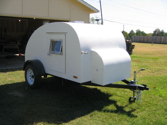

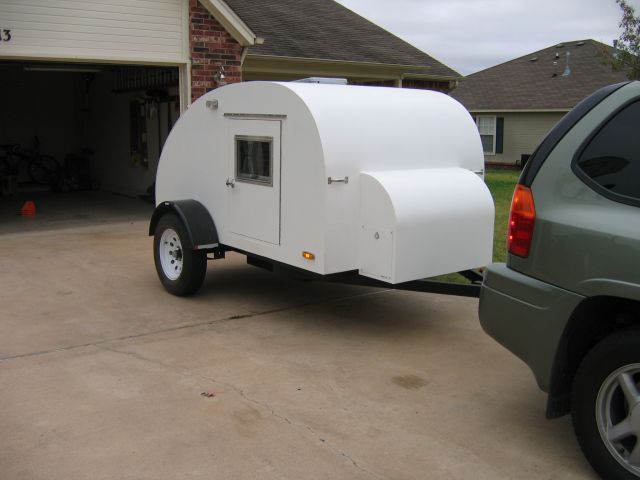

Here is the latest picture of trailer with completed tongue box.

Got get it ready for the trip to LCG in Louisiana! Fun Ahead!

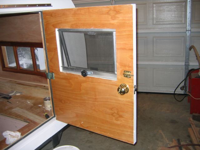

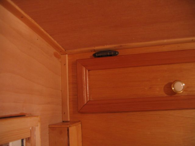

This has been a busy 2 weeks. We got to go to the LCG campout. It was fun the TD towed just fine. This last week the windsong went back to the shop. The next item on the plans is finishing the cabin area. This evening the the tongue box entrance was trimmed out and the cabinet doors were begun.

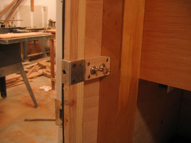

Light switches for the porch and cabin lights.

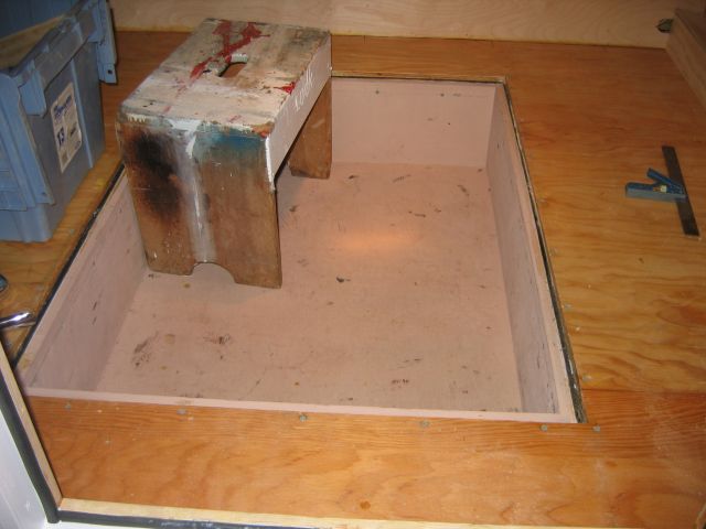

The under floor storage box after 3 camping trips is showing wear! I haul my dutch ovens down there.

Hey JP,
I did not get to talk to you at the LCG, but I saw your tear when you rolled in.
How about lining the underfloor storage with some kitchen cabinet shelve liner. It stays in place and is a bit cushioned. I use that in my galley and everything stays pretty secure.
Just a thought to keep your pretty storage area from getting scratched.

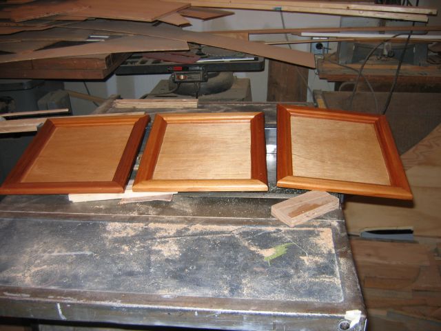

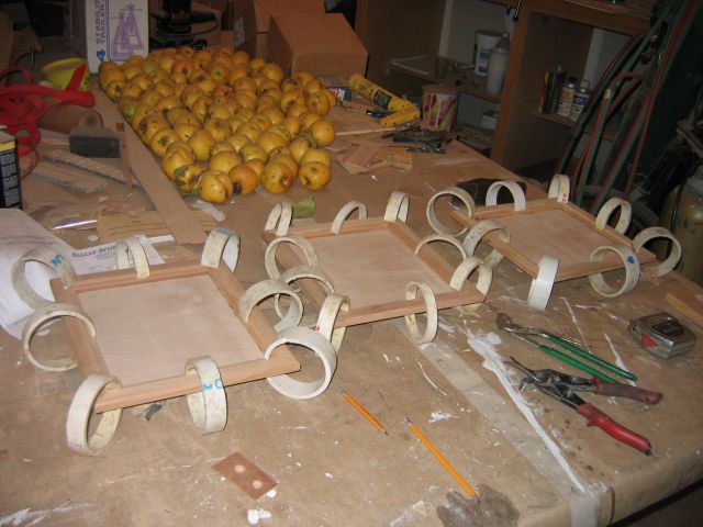

I glued the cabinet doors this evening, and used the PVC clamps.
How do you like them apples? Actually it is the clamps!
Location where cabinet doors will hang.
Finishing out cabin with trim is now under way.

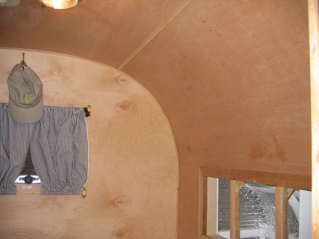

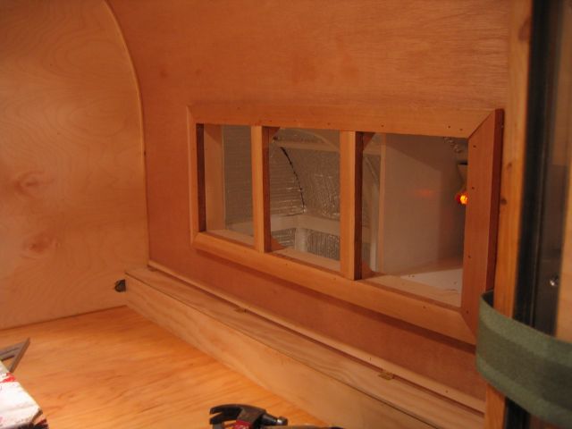

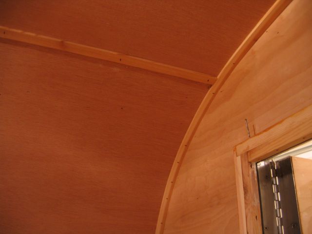

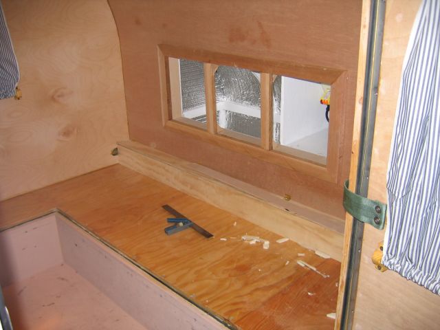

Postby jplock » Sat Nov 11, 2006 8:55 pm
Well today on Saturday more progress has been made on finishing out the cabin area. There has been more trim put up. The nail holes have been puttied with Fama Wood Putty, and sanded. Also soon I will have some pictures of the cabin vents to be added, and the cabin will be finished with Minwax satin finish spar varnish. Also today I puchased a breather mask suitable for use while finishing cabin. It is supposed to be good for paint fumes and chemicals. I still plan on having plenty of ventilation while applying varnish.
First coat of varnish on door Minwax Spar Varnish satin finish.
Varnish applied to cabinet doors that will go to the tongue box area.
More trim applied.
Trim in the bulk head area.
