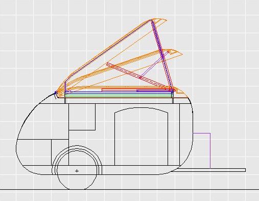

Postby angib » Tue Jan 16, 2007 12:37 pm
Roly,
I did something very similar a while ago - OK, it was to make a double-decker tear when in camp, but I think the folding method would suit your design, though maybe with the back end going up, not the front.
Inside the folded-down box, the red bit is the front panel, the blue is the right side panel and the green is the left side panel. The mauve lines show two struts from the roof that pull up the front panel as the roof goes up - but I think these are unnecessary when hands will do the job so well!
Andrew
Postby dwgriff1 » Tue Jan 16, 2007 4:08 pm
Andrew,
Isn't that the basic concept of an A-Liner? A solid side popup.
Seems like a design that might be useful many places. I am still stunned by your "Compact" pop up roof. Haven't figured out where to use it yet, however.

Postby angib » Tue Jan 16, 2007 5:23 pm
dwgriff1 wrote:Isn't that the basic concept of an A-Liner?
Pretty much. One difference is that in order to get the sides as high as possible, it's necessary for the left side to fold down over the right side, or vice versa - on an A-liner I think each side is less than half the trailer width, so they can fold down together.
Andrew
