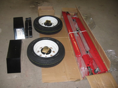

This is how you get the trailer from Harbor Freight. It is about 260 lbs.

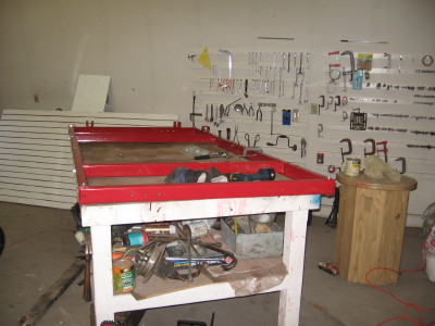

I have the main part of the frame assembled on the worktable. If you want to see an excellent pictorial on building and modifying the frame, Dee Bee has some terrific photos.
I am ready for my friend the welder to stop by so we can widen the frame. I think you will find it interesting. It will be a day or so as nasty weather hits tomorrow. Snow and high winds.

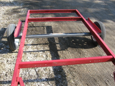

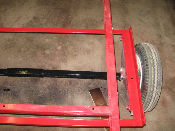

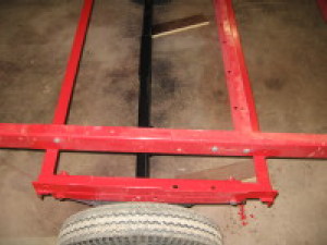

We were able to get our welding done yesterday. Trailer is now widened so we can go 5' wide. I used some good angle iron and made some modifications. After the axle was cut, a 1 1/4" bar fit perfectly inside the U channel. We fabricated a piece of U channel to match pretty close and that was added also. We slide the axle back in the process.
The idea is to run some 2X4 rails up the side to carry the weight. Not sure how I am going to build the floor yet, but I am open to suggestions. I am useing the Benroy profile and will make the walls flush with the siderails to hide them.

...glad it stopped snowing long enough to get that far...looks like you and your weldor buddy did a good job on the frame...

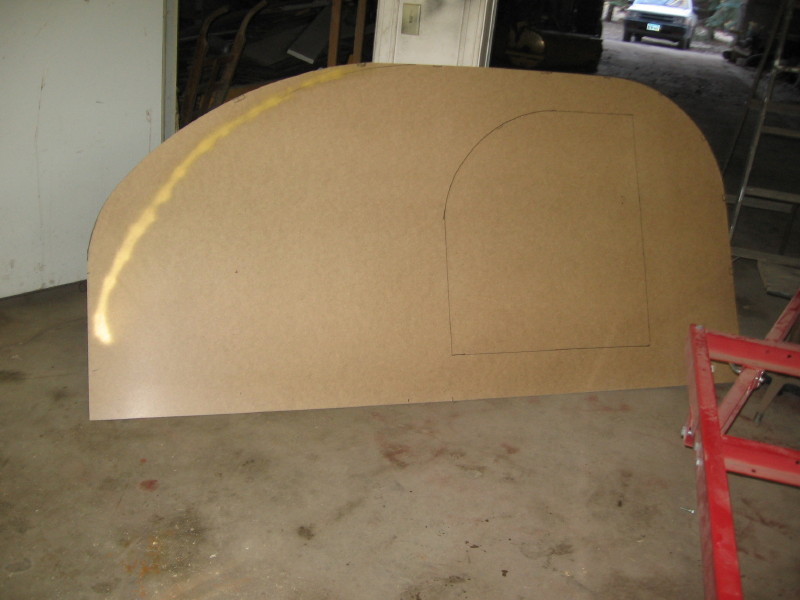

Postby Bigwoods » Sun Apr 15, 2007 9:47 pm
I was able to get some paint on the frame this week end. I am pleased with the outcome. Still working on the floor design. I think I will have side rails and slats going across. 2X4 up the sides and they will be notched to hold cross member slats. Some will be hardwood for stength, covered with plywood to hold it all together.
If anyone has a suggestion let me know. I do not know how Jim Marshall did his.
Side view of added "carriage" I think it will work well.
In the background is the profile cut out. Need a bit of fine tuning. I am using the Generic Benroy plans. The racing stripe will not be in the final paint scheme.
