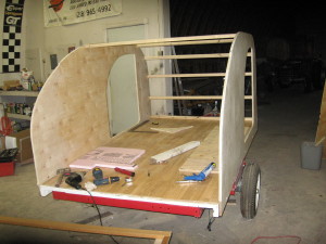

Thought I would start a new thread for the Northwoods since I hit a milestone today and am past the start phase.
Walls are up!!

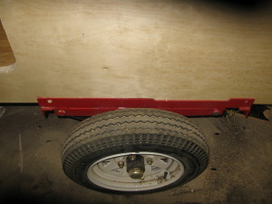

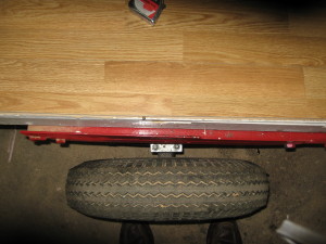

This is the axle carrier. I left a 3/4" space to carry the wall. There is just enough gap to insert the wall. The wall will hide the wood frame supporting the floor.

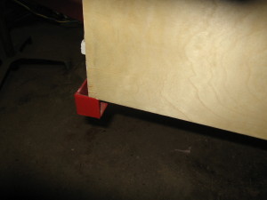

The wall is in place, totally supported by the carrier.
If you remember the front support I added, it will support the front corner of the wall. Needed a little more muscle, so it is not seated yet.

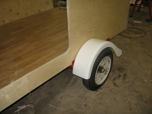

And what is really cool is the I have a set of Kerry's fenders. WooHoo! I had to set them on the tires to get an idea of how they will look. I am very pleased. They are made very well and are just terrific! I can't wait to get to the part where I am mounting the new fenders. They will be a snap to attach.

I need to cover the carrier some how. Making a woodie might be just the ticket as I can cover it with trim. They stick out past the fenders just a bit.

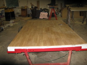

This is the floor, before wall went up.

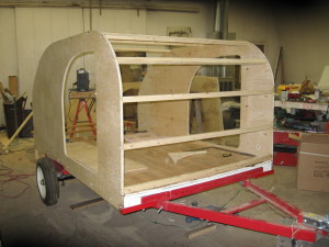

Progress is continuing on the Northwoods. I have the spars on the front and am starting to work on the galley area. I decided to step back and reconsider my needs. So far all is gonig well.
Things that I would do differently on the build so far are cutting out the sides and the doors. That was harder than I anticipated. If I were to do it again, I would get a better jig saw. I strayed from Mike's method and tried doing it with a router. I think the jig saw would have been better.

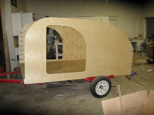

This is the front view.
A view from the back.
