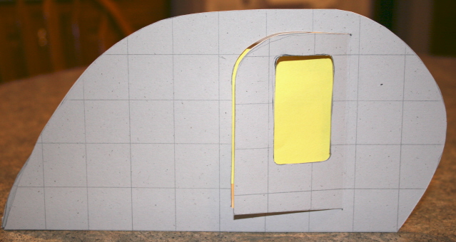

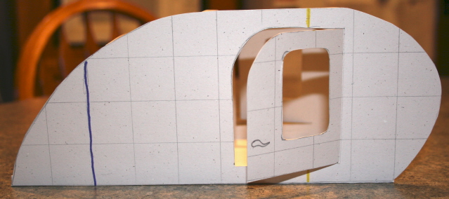

LittleCritter wrote:Kens - I'll be pulling it with a 2002 Dodge Caravan 3.3 L.
Cabinets in the galley - able to get them - which one were you thinking would be difficult to get the cabinets into, the 4 foot high or the 5 foot high?
Podunkfla - We do have a router. I also took a look at the jig saw in the garage today and bought new blades - multiple ones - for it.
I bought materials for the floor this evening after work.
Miriam C. wrote:You have a good design Darla. I like the last one. If tight spaces are an issue you might want to cut some cardboard or hang some sheets to about the right size. 5' tall is not too tall for 10' long. Mines is and a part of me would like to make is smaller. Everything costs more when you go that big. It is also harder to reach if you are small.
I would split the plywood at the bulkhead. Your cabinets and bulkhead will tie them in from top to bottom better than at the front.
Good luck and Enjoy
