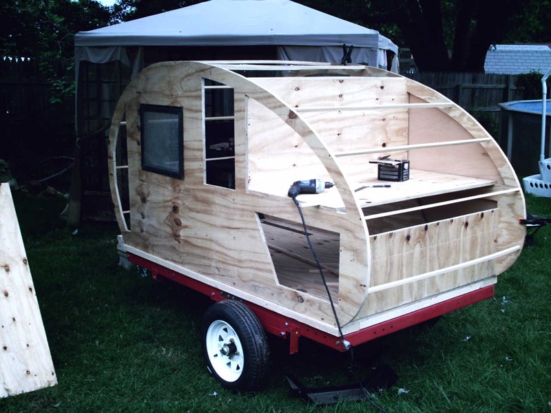

glennsheila wrote:I will be attempting a 6x10 trailer with solid 5 foot plywood walls. Would you suggest 3/4, or 1/2 thick walls. Thanks for any insight.
Miriam C. wrote:Either will do but if you use 3/4" you can rout away a small lip for the ceiling and roof spars to sit on. Makes the ceiling so much easier to put in.
