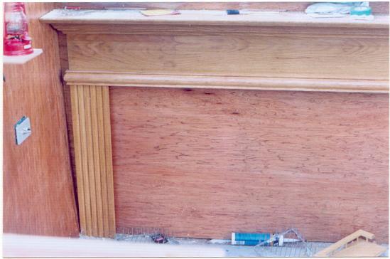

headboard
Postby bobhenry » Mon Sep 10, 2007 1:00 pm
Wanted a nice shelf on the galley wall and I had this oak
fireplace mantel stored for 7 years didn't know what to
do with it until last month. I measured the mantle and
it was 5'4" my inside dim's on chubby is 5'3" close enough
with a real careful 1/2" trim on each side it became the
galley wall headboard. (Yeah We're sleeping feet first.)
The switch ( yeah I know it needs trim too) is ac flip
dc rotary just an arms reach away and lights up the
little $5 kerosene lantern that I converted to 12v halogen
and ac bulb looks so Kool lit up. There are a pair
His and Hers on each side!
