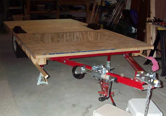

I did get the deck down and attached.

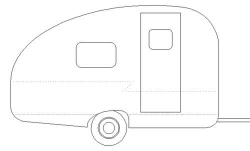

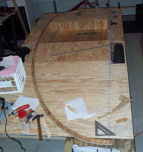

Then I decided curved rockers with an 'upswept' rear rocker would be more attractive. So...
Then, after I had the profile completed (after many-many redesigns), I decided one last time to 'enhance' the cuve from all radii, to one with an ellipse. The result will add about 1 1/2" to 2" more headroom over the table. (In theory). :thinking:
In reality, it actually simplified layout; consolidating two curves.
So I have curves... alright, almost ONE curve.
Current profile...
So progress. SOME progress.

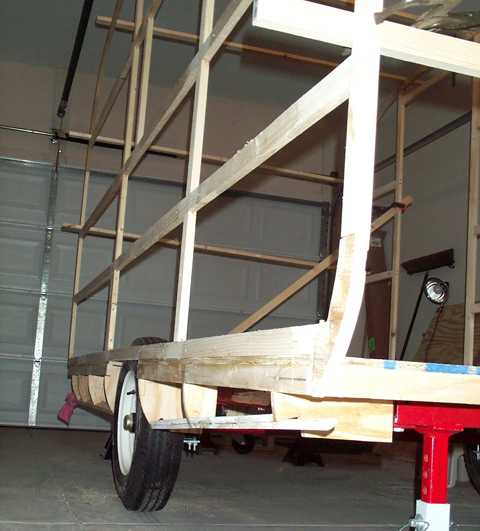

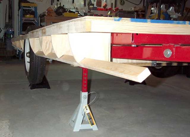

Verdict on rockers...
Postby LesterS » Tue Oct 09, 2007 6:54 am
It remains to be seen if I can pull off the curve (both front and sides), without a major hassle. Right now, it's ribs and a spine. (Spline?)
I intend on covering with thin ply (1/8"), and then epoxy coating in & out. I will likely have to add weep holes so moisture cannot collect near the bottom. - I don't want them to rot like '70 chevy quarter panels!
My second concern will be obstacle clearance, and road debris. That is one reason why I chose to taper the rear section upward about 4 inches.
Currently the sides do not reach as far down as the drop well - which should have a road clearance height of about 9 inches.
I appreciate the complements, but I've seen everyone else's work,and I got a lot catching up to do!

Postby Podunkfla » Tue Oct 09, 2007 3:24 pm
Lester... Those curved rockers are gonna look great! You could fill in the hollow space with expanding foam? Then sand down flush with the wood... then fiberglass/epoxy the curves. A lot of fenders and similar curved things are done that way. Even compound curved corners can be done like that.
It sure looks like you are on the way to one amazingly unique TTT. :thumbsup:

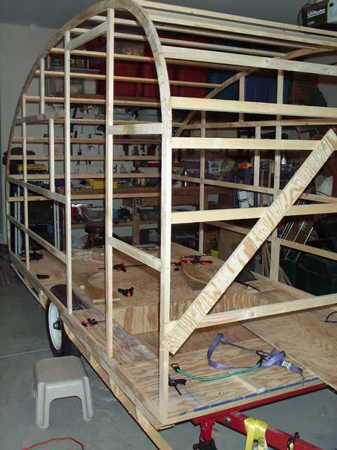

Postby LesterS » Sat Oct 20, 2007 8:36 am
I got the sides framed, biscuited & glued every joint. (Titebond III) Then I sanded each join to ensure it was flush. (Lining up for biscuits is hard on small dimensional lumber.) :roll:
Then I glued and screwed the sides down through the deck to the deck frame using 3" deck screws. (That should hold it!) :thumbsup:
All the 'roof' spars are glued and screwed (no biscuits - too much effort).
So now it has a SHAPE!
One confession:
Measure THREE times then cut. The trailer is 1/2" TALLER than my garage door opening! D'OH! :shock: It's ok though. If I drag it out with the toungue on the ground - it'll clear. - Barely. Good thing it's gonna be outdoors after completion! (After the OUTSIDE is completed.)
