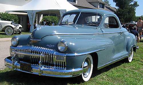

Postby bve » Tue Oct 23, 2007 9:41 pm
That's a cool looking trailer for sure... :thumbsup:
I'd go with fiberglass construction, speaking with absolutley zero experience with it.
As soon as I saw it I thought '48 DeSoto for the TV.
