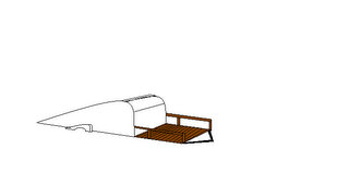

Hey Guys,
I got a good deal on an old boat trailer(free), and i was wondering what to do with the extra length. In the quest to be different i though i would make a regular 8' tear, then with the extra footage, there could be a small deck on the front. Kind of like the Lil Guy sport tear. I can guess there would be some more braces to be welded on for the deck, would this work out? I drew some pictures of it, but i can't get it to upload. What do you think? :thinking:

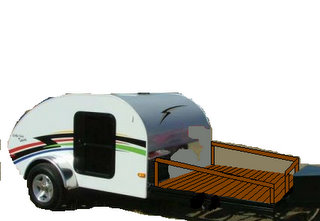

Postby Ivar the Red » Sat Dec 15, 2007 5:02 pm
Hey Guys,
It took me a while but i fingered out the picture problem. Now i can show you what's in my mind, oh that's scary. :twisted:
Does that help? :thinking:
Johnny

Postby toypusher » Mon Dec 17, 2007 8:11 am
I don't know about the strength of the trailer, but would think that if the weight of tear is sufficiently towards the back to offset any weight added on the rack you are building in, you can keep your tongue weight managable. You might need some strengthening in the tongue area of the trailer, but I don't know much about that.

Postby Miriam C. » Mon Dec 17, 2007 11:09 am
Johnny if you have a picture and discription of the trailer you might go over to the "trailers" section and ask if it needs to be built up. It will depend o what you are pulling it with and what you are carrying.
Elmo has one built that carries his bike just fine. Btw---love the drawings.
Postby angib » Tue Dec 18, 2007 7:41 pm
Johnny,
Strange as it may seem, adding that big deck at the front probably won't change the hitch weight much compared to just the teardrop bit - as you extend the tongue the hitch weight goes down a bit but this is compensated by the extra weight of the tongue and deck, so the end result is much the same as with a short tongue. This assumes a light deck - if you start throwing 2x4s or larger at it, it will get heavy and give you a high tongue weight.
But all this is assuming that the axle is in the 'right' place for the teardrop - just as you've drawn, that would put it a long, long way back on the boat trailer - like within a quarter of the trailer length or so from the back. But then many boat trailers have moveable axles, so that may be easy to do.
Andrew
