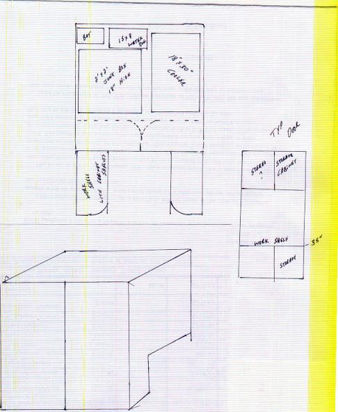

Postby bobhenry » Tue Apr 22, 2008 9:15 am
Drew up a 4x4x4 box with a step down door.Image
Plan the step down to rest on an inverted ball mount without the ball and bolt thru the bottom of the step down and thru the ball mount to prevent the patrol box from walking. Adjust the dimensions to fit snuggly in your cargo area. The step down is to get your workshelf to a 35 - 36" work height. The 12" deep doors fit into the outer shell of the box. If the back wall of the box was also shelved you could gravity feed your water by placing it high on the back wall.
The 24"x24"x18" tall junk box could contain a smokey joe jr grill or small white gas stove charcoal and starter and all the other camping hardware. You can pull it out and use it for the grill stand or a seat. If the junk box height was designed to match the step down I could support the patrol box when out of the vehicle as a base. Electrics could be as simple or as elaborate as you could make them. Don't forget your fuse and disconnect switch.
