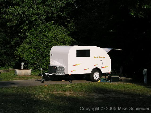

mikeschn wrote:We built our Baja Benroy on a custom chassis. I think the 4x8 chassis is too small.
If you could do a custom chassis, shoot for 54" wide by 10' long.

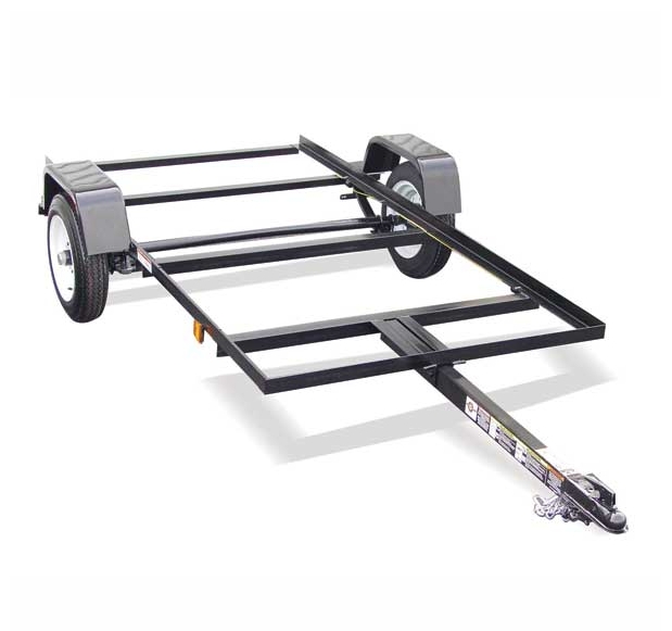

TheDuke wrote:Joe:
I had the same problem for the frame of the Skeet'r II. I found a good HF trailer, but after adding freight and delivery, or gas to pick it up, plus messing around with modifications, I decided Mad Jack was right. Design exactly what you need, buy the steel locally and cut the pieces to length, and have a friend come over and weld it. I think you said you had a welder? You're half way there. Unless you have a HF store next door, cost is about the same and you'll have exactly what you need. Just a thought.
TheDuke

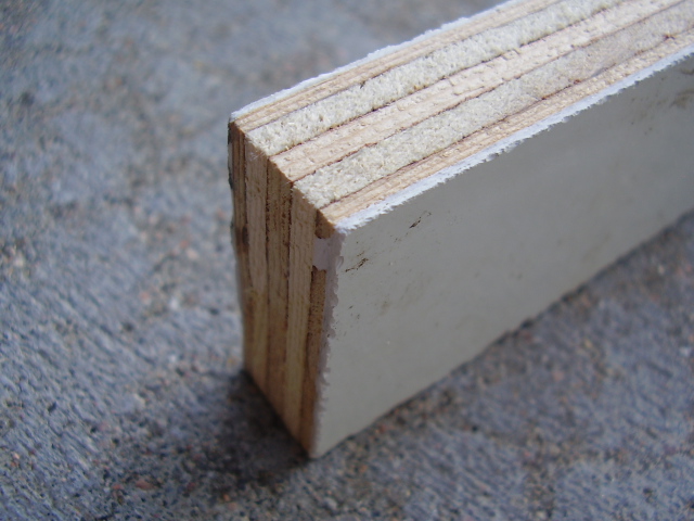

joecnc2006 wrote:Does anyone know where to get the FRP material, a laminate plywood, I have only seen it used on Gerdo's benroy, and wonder why doesn't more people use it or i just have not seen more? It will be the walls, and floor all in one no skins needed as he did. here is a link to his benroy and also a picture of the material.
I think it is a very good idea, granted it will prob cost allot, but less work involved and i believe would be worth it.
http://tnttt.com/album_ ... &start=132
Joe
