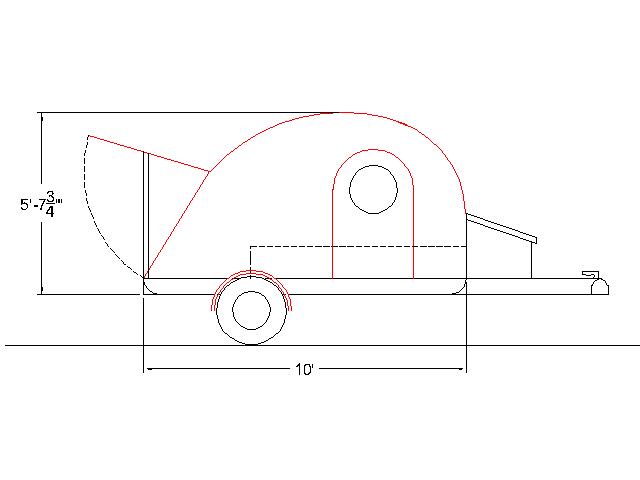

This is my deisgn that I have come up with that has everything that my wife and I need. I'm new to teardrops but not new to designing and cad. been through about 10 or more profiles and this one is the one I'm going with. Its 6' wide 10' long with an interior height of 5'. Personaly I would have went with the standard 4' but my wife wanted more height due to the fact she doesn't like to be too confined. Also i have incorporated a flat galley hatch to make construction a little easier and and still get the teardrop style. Hopefully will have some renderings up by end of the week.

The profile looks great. You may want to look at the height of the hinge point on the hatch. Looks like you need some headroom clearance to get up to the galley.

Postby Lance » Wed Sep 23, 2009 8:14 am
Actually currently at the back where the bumper would be it measures 6'. Lifting hatch door a little will eliminate the problem. I may look at moving hinge point up a little. I am also tossing around the idea of putting the AC above the hinge in a trolley car style scoop. like i have drawn below. Also my axle location will move once all my calculations are complete.

Postby Sam I am » Wed Sep 23, 2009 9:18 pm
Very nice, Lance! I do have just one nit-picking suggestion: Where the curve meets the straight hatch, I think I would adjust the curve a little to make the hatch line tangent to it. This would eliminate the little "bump" at that point. Just my preference.

Postby Lance » Wed Sep 23, 2009 10:21 pm
Thatsa good idea. Just never thought of that. Thats why I posted my idea so I can get help from the veterans.

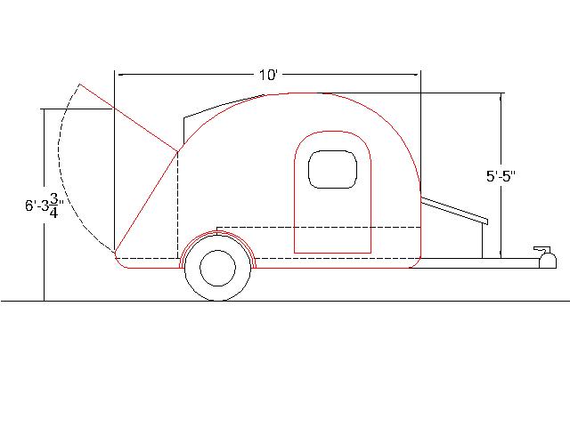

Postby Lance » Thu Sep 24, 2009 4:25 pm
Revised profile a little. Think I like the new profile more. took into account making the rear curve tangent to hatch:D

Postby Lance » Sat Sep 26, 2009 11:47 pm
I think I may scrap this idea. The more I look at it the more it looks like a bubble. I think I may just go with a Benroy shape and just stretch it and change radius to fit my likeing. The more I look at the Benroys the more I like them. I'll just have to take my time doing the hatch to prvent springback. I may also get the hatch frame made from alluminum to avoid the chance of spring back. :shock:

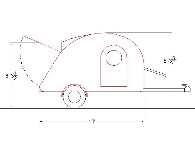

Postby Lance » Mon Oct 05, 2009 2:38 pm
I'm sticking with my last profile. All except for the trolley car scoop for A/C. going to put ac either in bulkhead or through side wall with a small door with a sliding tray. Working out my galley layout and started doing some 3D this past weekend. As soon as I get something I'll put it up.
The size is the same except for the width is down to 5' wide. I'm sticking with the 10' length and 5' interior height. I'm thinking of doing my galley similar to bobhenry's.

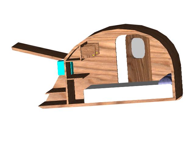

Quick rendering
Postby Lance » Sat Oct 10, 2009 1:24 am
Here's a quick rendering of the body of the tear without the trailer attached. Just threw a quick model together to show what I had in mind for the layout. at the foot of the bed I will put baskets to store clothes and things in.There will be slides on A/C so when not at camp it can slide in. Shown is the drivers side wall but the passenger sidew wall bill be the same.
