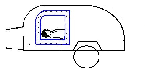

This is my first attempt at using a cad program to design something, Usually just spent hour upon hour with graph paper. 10' x 5' rimple.

Nice size tear plenty of room. I think you will have a stiff neck if ya sleep like the dude in da trailer :lol: :lol: :lol:

I think the Rimple is a great design that maximizes usable space. I very seriously considered a Rimple design, although I eventually went with a modified Weekender design.

I like this design best so far. I cook mainly over an open fire so a galley would be near useless for me, and am a big guy 6'4 240 so i need as much room as i can get. i do plan on adding bracing on top to haul a 4x8 fiberglass boat. I think i will skin it with aluminium then paint. There will also be a door on both sides. Feel free to throw some ideas at me if you have any. And as far as my skill levels, i used to work on custom cars, interior mainly such as stereos, lighting, tv's etc., and also built amature level props for a local haunted house.

I also like the rimple design and gave it some thought early on. This is probably not your final rendition, but, I think you are going to want to move your doors forward some so as not to interfere with your fenders/wheel wells.

But like Mike said, once you get your wheels in there, you'll have to move the door forward...
Also, I would make the back radius a bit larger. It just looks better!

I see what ya mean about the door and wheel dilema, i didn't have the trailer accesible when i did the sketch (it was at home and i work) but am now working on the improvements. And also like the idea about the larger rear raduis. Thanks this is the kinda stuff i was looking for

I like your first idea better, once the doors are adjusted to allow for the wheels. The Rimple is a great design. :thumbsup:
:thinking: Idea to consider: It doesn't look like you plan on a galley or a galley hatch; but, if you change your exterior storage compartment door so that it opens upwards instead of downwards, you might be able to add braces and use that storage door as a countertop...or as an extra place to set things when you're rummaging through your storage.

Great suggestion on the rear storage lid as a counter top :thumbsup: . Keep the ideas coming.

I don't think I have ever seen a TD with a duct system A/C. I love the moon roof also.

Well, i thought the duct system for the ac was a must because we didn't want the air blowing right on us, now i just have some technical issue to figure out so it will work. And i'm currently working on a CAD design to included the suggestions and fixes. I think i'm gonna move to the journal forum so i can show my progress from begining to end. Thanks and keep the observations and suggestions coming. Gibby
