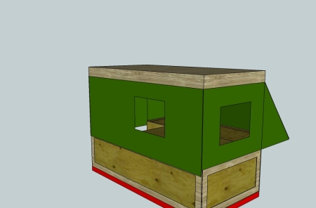

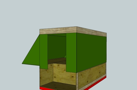

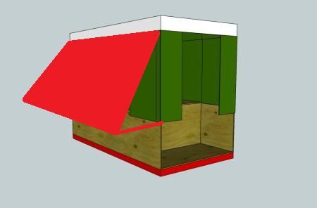

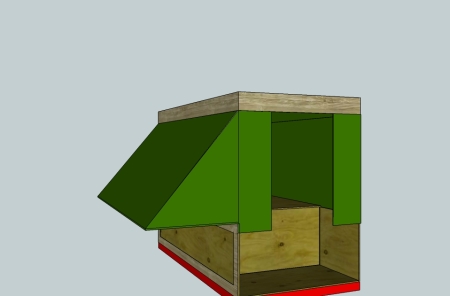

So, here is what I've been kicking around. This is the first time I've used Google Sketchup so please forgive the crudeness of the diagrams.
I don't have a name for it yet, but, generically, it's a 3+ person tent top pop-up with a small area big enough to stand up in. Built on a typical 4x8 trailer.

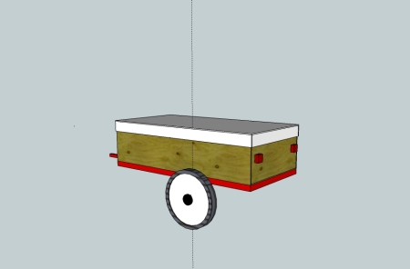

Trailer in collapsed, road form...

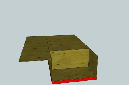

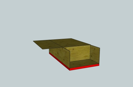

Trailer Box from the rear without the roof or tent... small extension unfolds to form a 6.5'x6' sleeping area. Should be big enough to house 3 people without being too cramped sleeping sideways...

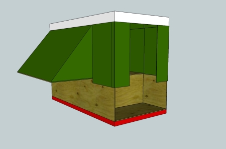

These images are with the tent fabric attached. I figure to use marine grade vinyl. I didn't show any wheels or doors in any of these images...
Front Right Side...

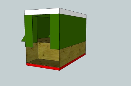

Rear Right Side...
Rear Left Side...
Those are all the sketches I have so far. I think you get the basic idea.
A small 2x4 area in the rear that's high enough to stand in (if you're under 6', anyway). Could be lengthened to 3x4 if I chose to extend the box beyond the trailer frame, I suppose.
The box itself is constructed with 1/2" plywood for the outer walls and sleeping platform. Probably 1/4" for any interior dividers.
Still haven't quite decided on the roof yet, but leaning toward 1/4" plywood or perhaps 1/8" around a 2x2 frame, depending on which is lighter?
Compartments under the bed for storage... accessible via a doors on the front and in the standing area.
I figure to do a non-stitch work-up on the tent. Overlapping corners with velcro. Snaps attaching it inside the roof and to the sides.
No hard framed door on the upper part of the access point in the rear. I'll do some sort of tent style door... overlapping with velcro that I can just roll up if I wish to get it out of the way.
I also haven't quite figured out what to support the roof with. The roof will probably be lifted by hand (should be doable with 2 people) so I don't think it needs to be anything elaborate. Maybe just some poles in the corners?
Anyway. Thoughts would be appreciated.
-TJ

why not just make that whole side of the camper fold out. It would be easier to put together the tent and you would get a little more room inside, a small place to sit down and someplace to put things next to the bed.
I've also been working on another idea similar to what you have.
I was thinking to make the bed the same size as the bunk off a regualr popup and just recycle or buy new canvas to use. Replacement canvas for one end of a popup can be found for around $350. And using that method, there will already be windows and screens built in.

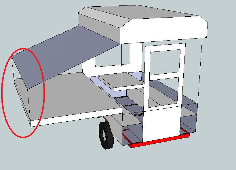

Postby TJinPgh » Sat Jan 21, 2012 8:10 pm
Adam,
I hadn't thought much about it but I can see where that might have it's advantages.
Didn't have time to adjust the rest of them but I did do a quick mockup on the box itself...
So, for the cost of a little more vinyl and maybe another 5 pounds I'd get another seat.
I like the diagram you posted on yours as well. I'll check out the other thread you posted to. Would like to read more about it.
I thought about leaving the whole box area open to maybe put in a table or something like on yours. In the end, I wanted the storage space that the closed box provide.
I'll be curious to see how yours turns out, though.
I don't even have a trailer yet so I'm not really all that close to a build.
Although, it occurred to me earlier that, since it would be done on a standard 4x8 frame I could actually go ahead and build the box and simply mount it on the frame when I get one.
-TJ

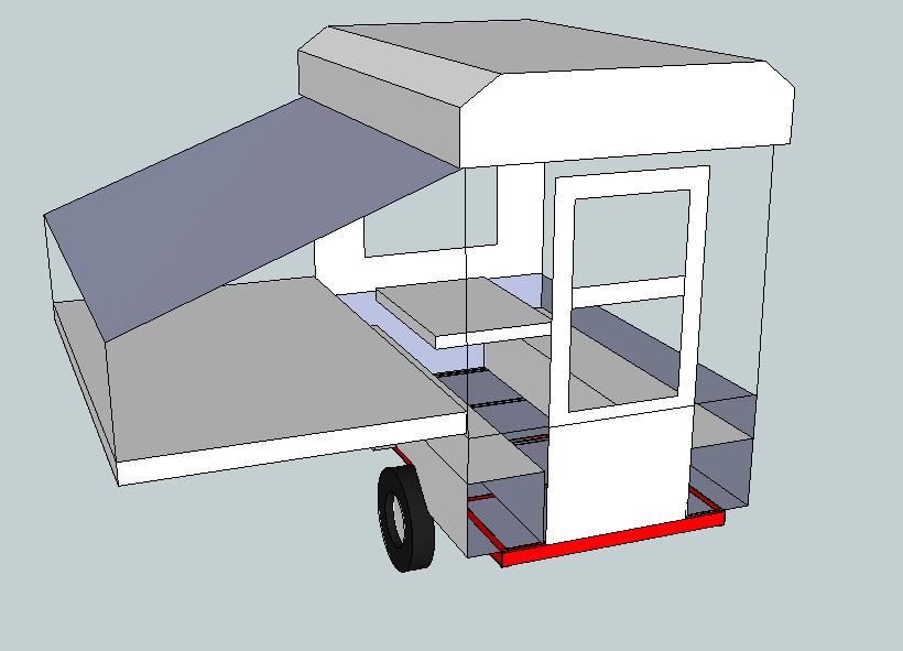

Postby TJinPgh » Sat Jan 21, 2012 8:44 pm
Went ahead and tweaked those others...

Postby adam25 » Sun Jan 22, 2012 10:52 pm
TJinPgh, right click on the the icons and you can see the URL for the pics Scott posted. They are of a trailer similar to your idea that the roof opens 90º to form one side of the tent.

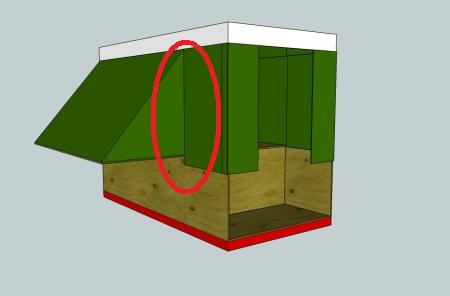

Looking at your pics again, you may want to add a small vertical wall at the foot end of your bed
If you do a straight wall from the roof to the bed, you will loose out on usable length on the bed as it will become too narrow at the end. Plus any part of your bedding touching the tent will get wet if it rains.

Postby TJinPgh » Sun Jan 22, 2012 11:14 pm
adam25 wrote:Looking at your pics again, you may want to add a small vertical wall at the foot end of your bed
Adam,
I thought about that initially. That would obviously require a prop to hold that upper corner up in place. I'd also need to give some thought as to whether or not I could simply velcro the side panels in place with that.
As for the bedding, it's certainly a consideration I hadn't considered. I know that has been a problem in the tents I've used in the past.
I know that could be a problem with nylon or canvas... the wicking effect. I'm curous, though, if that would be a big concern with marine vinyl? Isn't that, effectively, a solid surface?
I know that certainly seemed to be the case with the vinyl I purchased to re-cover my motorcycle seat.
-TJ
