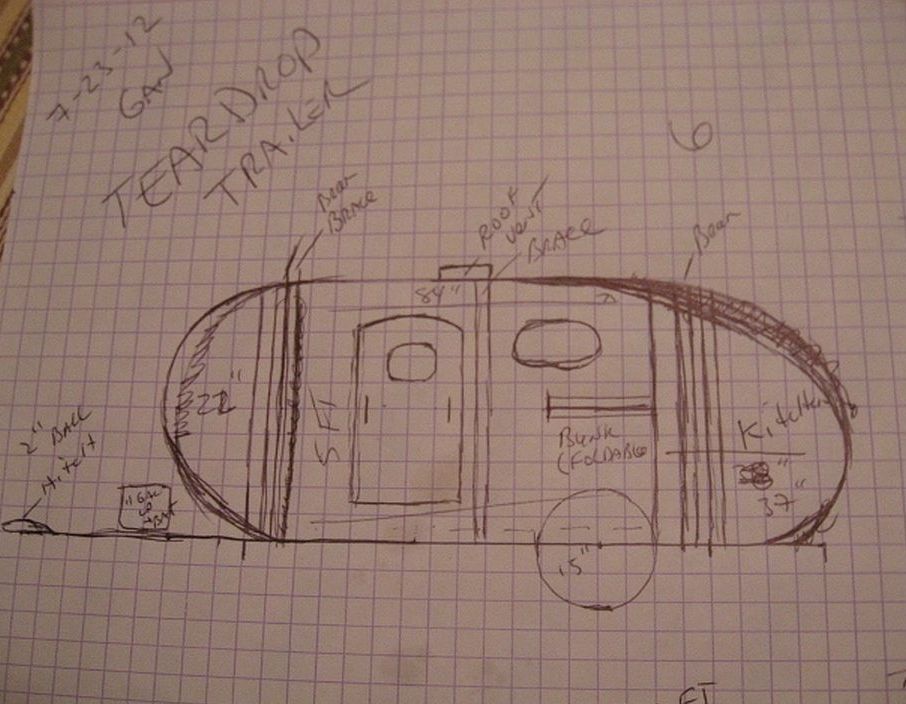

Postby Gnaatz1 » Tue Aug 07, 2012 11:04 pm
Fair enough...I will have to take some time to try to get some drawings put together...Graph paper might work.
But here is a very rough concept I have...not sure if it is to scale or not...Again 6'3" wide (allowing for both walls) giving me six foot across inside the cabin. I am allowing 22" (overhang on front end - curved out) for my possible hanging closet and cabinet area in front. Then my main cabin (sleeping area) would be 84" long by again 6" wide. Then I would put of a flat wall dividing the cabin from the galley. On the back wall about half way up the height of the ceiling 5', would be the foldable 40 inch wide shelf folding towards the front of the trailer (when not in use it is used for storage of our stuff). The galley wall to the rear of the galley would be 37" deep. I would put a 15" x 15" sink in on the left side of the galley, with a 7 Gal. blue water container with drop in 12v pump directly underneath the counter. Next to the water jug with 3/4" ply wood divider I would put in my 1000 Yamaha generator lengthwise, another plywood divider, then my coleman steel 54 quart cooler - sitting sideways in a slide out (but lockable draw).
These were beginning plans and the width of the trailer is now 6 foot 3 inches wide (Tires outside of that - with fenders). The very nose to the curved rear (Galley area) will be 12 foot long. I think I've thought this through so far...but might have missed something.

Postby jdarkoregon » Wed Aug 08, 2012 1:16 am
So, what you going to pull this with??? and what you going to side it with? Be looking for a smaller sink, they are out there, 15 X 15 is way bigger than you need.
Why do you want it so large? I have a 12 footer and I have a couch to sit on inside. You have a lot of space that your aren't really utilizing. Have you considered just adding a foot in height and making a standy?
So, you are basically building a 6 X 12, with a 5 foot ceiling height. How about considering making a shelf on that 22 inch nose for your friend to sleep on and build in that closet on the galley wall, You will have enough height to build it and still have clearance for your feet.
Don't forget to go lite on the construction, It will be strong enough Please give us MORE behind the REASONS so we can begin to see your vision better. You've come up with a trailer that will give you lots of confort and storage. Tell us why you need or want it. WE ARE INTERESTED!!!

Postby Gnaatz1 » Wed Aug 08, 2012 1:58 am
I researched Camping Cots and most are 40 inches wide, and also saw some older campers with a similar setup for a bunk in them, so I figured I'd put in my Teardrop, so if I needed the extra bunk I'd have it and still have that space available for storage.
As for sinks...Where can you find smaller sinks - that are really functional to wash dishes in? Smallest ones I see have been around 15" square to my recollection. I am interested in finding something smaller though.
I was thinking of putting one of those drop in two burner stoves in it, but I think I'll save money and maybe a bit of counter space by going with a portable two burner with the fold out wind protectors either a Stansport or Camp Chef...that have gotten good reviews and they are cheaper.
As for pulling it...I have a Ford Taurus V-6, or a big GMC Yukon V-8 to tow it with at this time.
As for siding it - Early planning has it either being sealed and painted, or case in aluminum (if I can find a supplier here in Alaska that won't break my bank).
I really am thinking of putting a canoe on top - traveling and I am pretty short 5'6" so I want to be able to get it on the roof / rack fairly easily.
In trying to go lite...I totally agree...Right now I am thinking of using 3/4" exterior Plywood for the sides skeletonized so I can put in foam insulation, then putting exterior grade 1/4" Plywood on the outside and 1/8 on the inside cabin section. I would put two thicknesses on the roof for added strength and support for the canoe.

Postby jdarkoregon » Thu Aug 09, 2012 1:10 am
Hey, that is great construction, easier, faster and strong,
Take a trip to some sports place that has a display of cots. 40 inches is middle of the road, but there are some less than that. 31 inches or so. Yep, its small, but you're building a small light weight trailer, sometimes smaller works just fine.

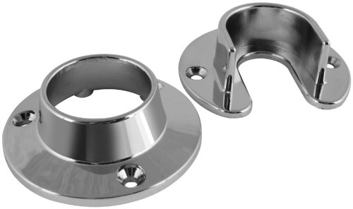

As for smaller cots...I checked out Cabela's site last and you are right, some cots are only about 31-32" wide...I think I will downsize that to a fold- down canvas cot taking it out to 33" wide, which I believe is the width of a normal size sleeping bag.
Plus a canvas cot will save some weight - Great Idea! The extra sleeping area will still be there if needed for an extra person as long as they aren't too tall. Now I need to find Chrome Closet rod holders, they will look the part.
I think I found them on Amazon...Now just thinking how much they would support - weight wise over a 6 foot length, but the back part would be support by the back wall of the main cabin and sides. I am wondering for safety of the person who might use the bunk...Would it support up to 200 pounds?

Postby jdarkoregon » Thu Aug 09, 2012 12:54 pm
Gnaatz,
I'm hoping you will share a first name and let all of us know where you are located in AK. There are a couple really good teardrop builders up there.
That suggestion to do some mock-ups is a good one. Don't forget to include the ceiling, You will be surprised at just how much space you are suggesting.

Postby Forrest747 » Fri Aug 10, 2012 4:38 pm
doing the math for those supports that i found on amazon
at 6 feet supported at the ends you need a 1.25 inch round dowel at a minum of poplar or stronger
the issue i have using that as a bunk for an adult is that i would not want to sleep under it.
I did see one built that had bunks for kids under 100 pounds and i would be ok with that.
200 is pushing it, for me.
