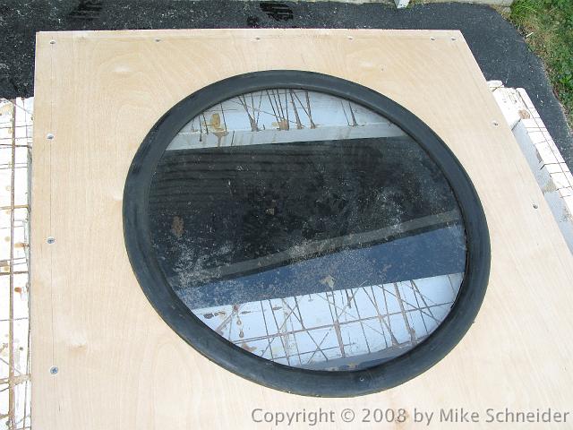

Make your own, using a router?
1) Make a circular recess in the body using the router pivoting around a screw.
2) Cut a piece of plexi to fit the hole.
3) Cut an exterior trim ring from 1/8" aluminum plate, again using the router to make the inside and outside edges circular. Drill and countersink the trim ring (outside the diameter of the plexi) for fixing screws.
4) Assemble the whole lot in place using a polyurethane sealant.
Need a diagram?
