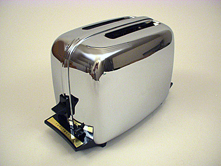

It's a Benroy profile, but 9 feet long (and 4.5 wide). We're calling it "the toaster" because I fixed on the idea of building a trailer like the 1962 Toastmaster toaster my parents got for their wedding and I grew up with. It's not completely planned out to the last screw, but we think we may be far enough along to start building *something*. (I'm chomping at the bit to make sawdust this very minute, Roy is insisting we plan things out.)
The link up there is to our diagrams. (we used the frame document from doug and steve as reference for our frame, and the benroy document as a starting point for our profile, btw!) Here's the link to our work breakdown thus far: http://www.brokenoffcarantenna.com/toaster/index.php?title=WorkBreakdown (thanks, honey!)
Are there any red flags we're missing?
the inspiration.

Ha Toaster, that is funny. The Benroy is a great shape. Any reason you going 4.5 wide and not 5 wide.

Postby nevadatear » Sun Apr 06, 2014 7:25 pm
So are the toaster slots skylights/ moonroof?

Re: The Toaster
Postby roymeo » Sat Apr 12, 2014 7:05 pm
nevadatear wrote:So are the toaster slots skylights/ moonroof?
How about black vinyl? We don't really want to open the roof up to leakage.
