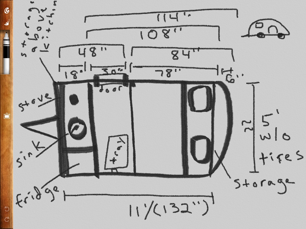

Postby jojofromwi » Thu Jul 03, 2014 9:29 am
**I apologize for the sketch being VERY rough. I'll eventually convert my sketch to a CAD program once the hairy details are finalized.
Ideas of mine (keep in mind that I don't have any building experience):
1. I want the door to open to a floor, not a bed.
2. I want the kitchenette to be inside the main cabin.
3. I want to fit a queen size bed in it.
4. Having the bed raised about 5", so the end can be used as seating, with a swing-out tray attached to the wall to be used as a makeshift table. (There'd be storage underneath the bed, when lifted.)
5. Instead of a traditional 4' ceiling, I'd make it 5.5'. (I'm tall, and don't want to feel like I'm slumping over the whole time!)
6. I'd put a skylight over the head of the bed to see the stars at night.
Problems I'm having:
1. Finding a flatbed trailer to meet my 5 x 11 specifications.
2. Making it light enough for my Rav4 to tow.
3. Having the mattress not fit too snuggly, to where putting new sheets on it is a pain.
jojofromwi
Posts: 4
Joined: Thu Jul 03, 2014 6:54 am
Location: Originally from St Louis
Re: 5 x 11' idea with kitchenette inside
Postby bobhenry » Thu Jul 03, 2014 12:33 pm

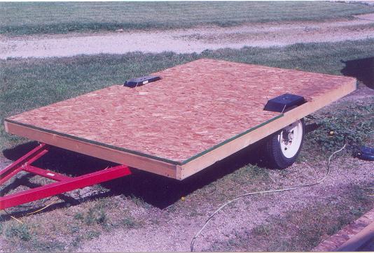

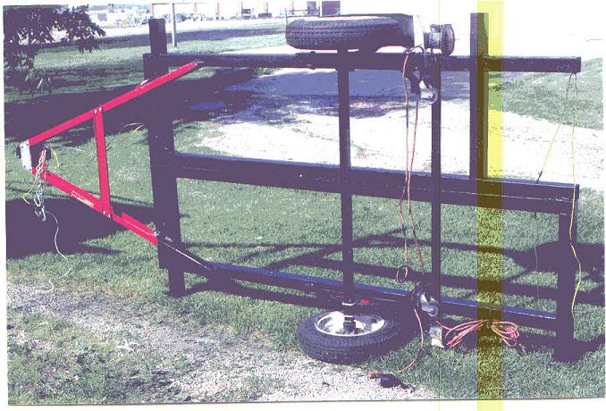

Chubby is 5'5" wide by 10' nose to tail and is on a 4x8 Harbor Freight frame. The frame was mashed and I had to modify a bit but ya work with what God gave ya. Cantilevering the support framing front to rear is not a big thing as long as you don't exceed a couple of feet.
You profess to be tall and you have your kitchen inside with a 5'5" ceiling are you going to cook on your knees?
You might rethink the rear galley they are under roof and gain you 16 - 17 inches of standing room.
We camp winter and summer and a popup make a great sun shelter or wind break.
besides everybody gathers in the kitchen......
Postby jojofromwi » Thu Jul 03, 2014 10:43 pm
Great advice-- thanks! Yes, I'm 5'11 and looked at T@B trailers initially, but even they were not very tall inside. My whole idea with a kitchen indoors was just wanting to cook up a meal without being swarmed by Mosquitos.

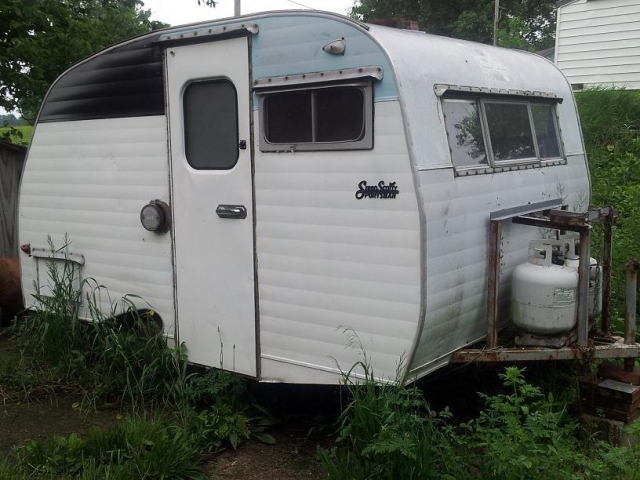

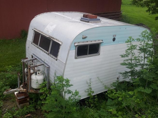

At those dimensions, you might look at rebuilding/restoring a canned ham trailer. They can be found 6'4" wide x 12' long and weighing about 1500 pounds. That's pretty close to what you had in mind.

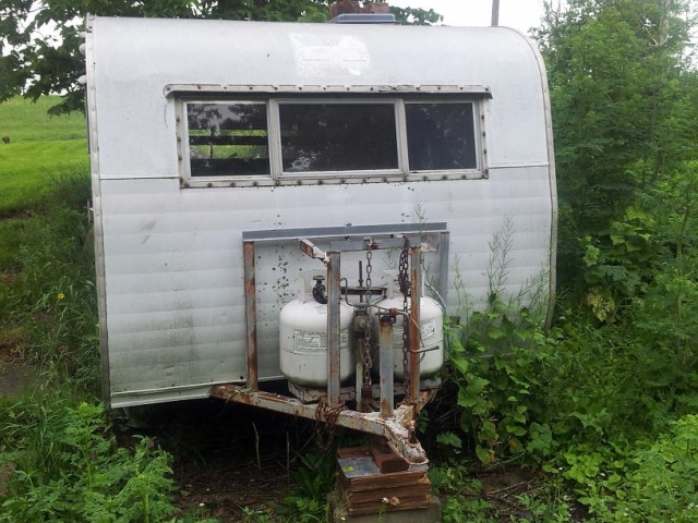

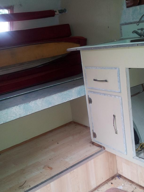

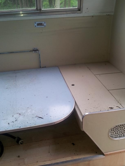

Might be an answer $350.00 in Lafayette IN...........
Postby jojofromwi » Sat Jul 12, 2014 7:55 am
bobhenry wrote:Might be an answer $350.00 in Lafayette IN...........
@bobhenry could I get more information on this? I'm not too far from Indiana, and have a trip there in a few weeks.
