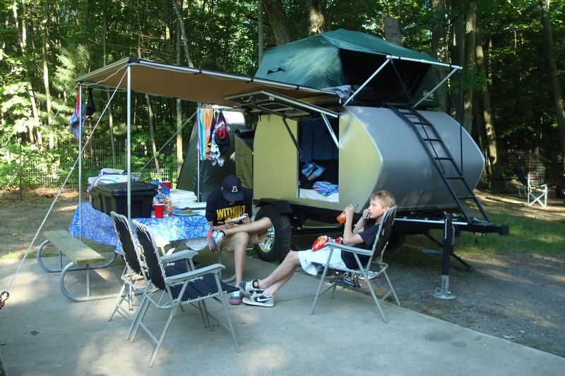

This is the best homemade that I think I've seen: Image
This picture is with the tent in the 'up' position. Check out Endo's album to see more.

My first reaction was maybe you should consider building a standy –that your needs are way beyond a teardrop. My second reaction is this: What you are considering building is complicated. I'm working on tear #3 and I think your concept is beyond my pay grade. You might consider the teardrop with the roof-tent (I mentally struggle with that idea. Piching a tent on th roof and having your teardrop roll all night? Plus, I'm one of those prostate-challenged up-in-the-middle-of-the-night kinda guys. Can't imagine being up in the lookout tower at zero-dark-thirty feeling for the top rung of the ladder with my bare foot.) But you could go with that and find out if they really want to camp with you. If they do, build a second teardrop from them. With your teardrop in a teardrop concept, I think it might be more straight forward. :thinking: :thinking:
You might take a look at the Camp-Inn Raindrop. I think their web page isn't too far back in the corner of the Internet. I think they might fit four. Even that, for me, is too many people in a teardrop. There's been a couple of them built and documented on this site.
