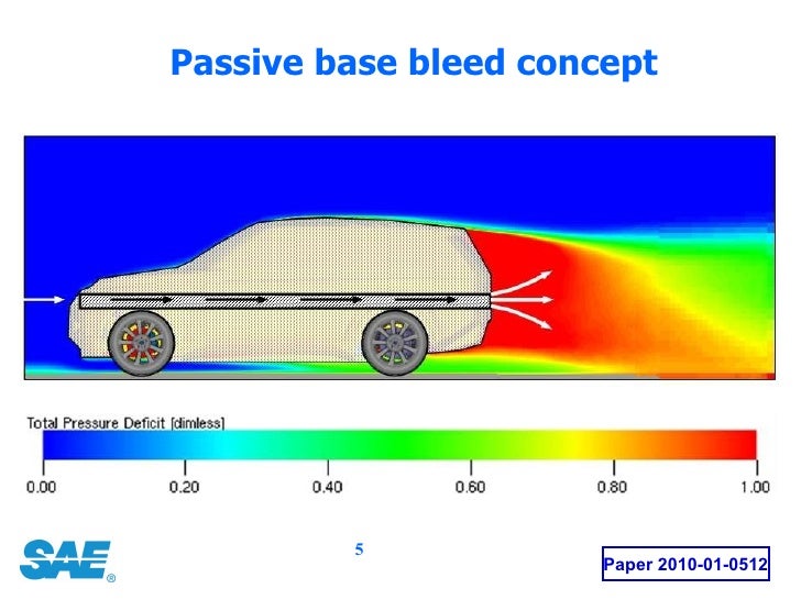

Now here's the only image I could quickly find for a modern looking SUV type tow vehicle. It's from an SAE paper by engineers at Jaguar looking at the effect of bleeding air from the high pressure in front of the vehicle to the low pressure region at the back. I honestly can't tell if this image is with or without that bleed air.
That red region is where a perfect trailer shape should fit to really reduce drag.
We see right away it's a pretty bad shape for a practical trailer. Too small and short and low to be comfortable.
But if you are truly interested in reducing drag and increasing fuel economy with the trailer:
- get as close as you can to that shape
- keep the trailer tongue as short as you dare so it's close to the tow vehicle
- keep the roof of the trailer low so it's not higher than the roof line of the tow vehicle
