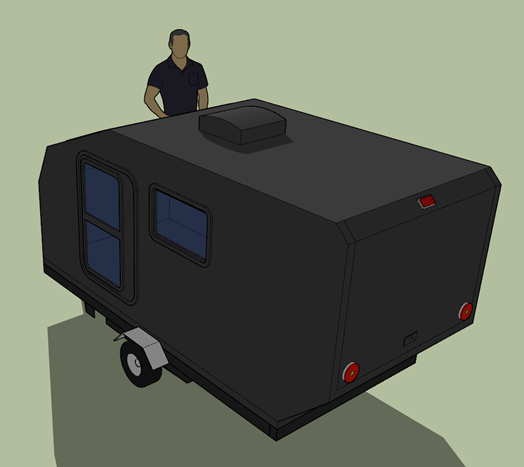

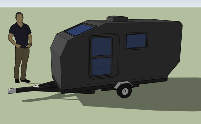

Hi all,
I'm new here but I'm ready to jump into the pool head first. I've been wanting to get into a tiny trailer ever since I found it they were a thing. During my digging I've kind of fell in love with the Square-drop style. I like the simplicity of the square corners and additional space.
*example I found on Pinterest.
I've started creating a few mock-ups in SketchUp of a design I like and I'm just looking for some feedback. I've tried to keep the dimensions as accurate as I can with my limited knowledge but nothing is set in stone. I've looked up doors and windows used by actual builders and taken those measurements into my mock-up. Things that I have not considered in my mock-up are wall thickness, insulation, water tank and wiring. These will be included in version 2.
I'll admit I'm completely new with all of this and I have basically no experience building anything like this. However, my brother is excellent with metal and fabrication and works at an RV dealership. Also my father is a world-class woodworker. So I've got some good people in my corner who can help.
Thanks for reading

What are you planning for a trailer chassis?
I think your axle is way too far forward. You should have 60% of the trailer weight forward of the axle otherwise you're 'drop will bob and weave while towing.

Postby QueticoBill » Thu Oct 12, 2017 6:36 am
There is a structural value to curves. The roof panel thats flat will sag and flex under much less load than one that is curved. Everybody's simplicity is different. I find less framing and thinner materials for equal strengtt simpler. Just a consideration.

Postby jdiebert » Thu Oct 12, 2017 7:01 am
Yea I've been going back and forth with that same thought. Do I go square or rounded. The more I look at other builds the more I lean towards a mix of the two. Right now with my current design I am doing an 18" curve at the front with a flat back (galley). Now having said that I may be getting an old tent trailer from a guy and it's a little larger than the HF and NT trailers a lot of builders use so we'll see how that alters the design.
