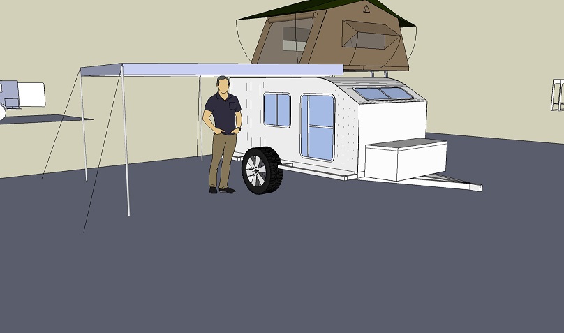

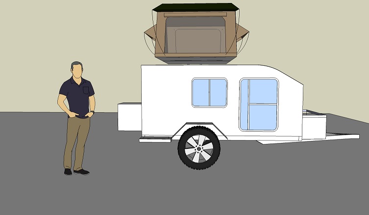

I am working on my first squareback trailer build/design.
Teardrop - exterior.jpg (51.53 KiB) Viewed 2943 times
Here are a few questions for the informed members.
- Roof top tent position. Should I move it forward more, or is it centered over the axle in a good position.
- Weight of galley kitchen an issue with fridge, shelves and cabinets?

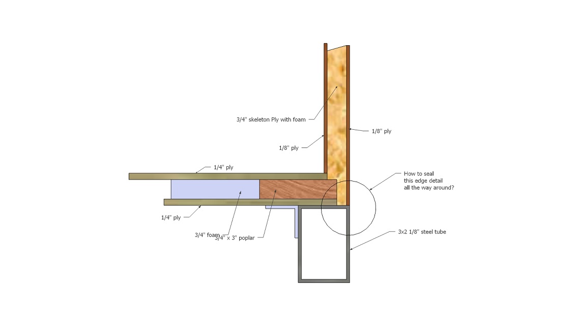

Building method is 3/4 ply with cutouts for foam, 1/8 skin inside and out. Floor in 1/4 skins and 3/4 cross members.
Roof in 1" lumber pieces with 1/8 ply top and bottom with foam in between.
Wall to floor attachment:
Teardrop Frame to Wall Detail.jpg (41.62 KiB) Viewed 2943 times
Any ideas how to seal that bottom edge of the wall to the frame?
