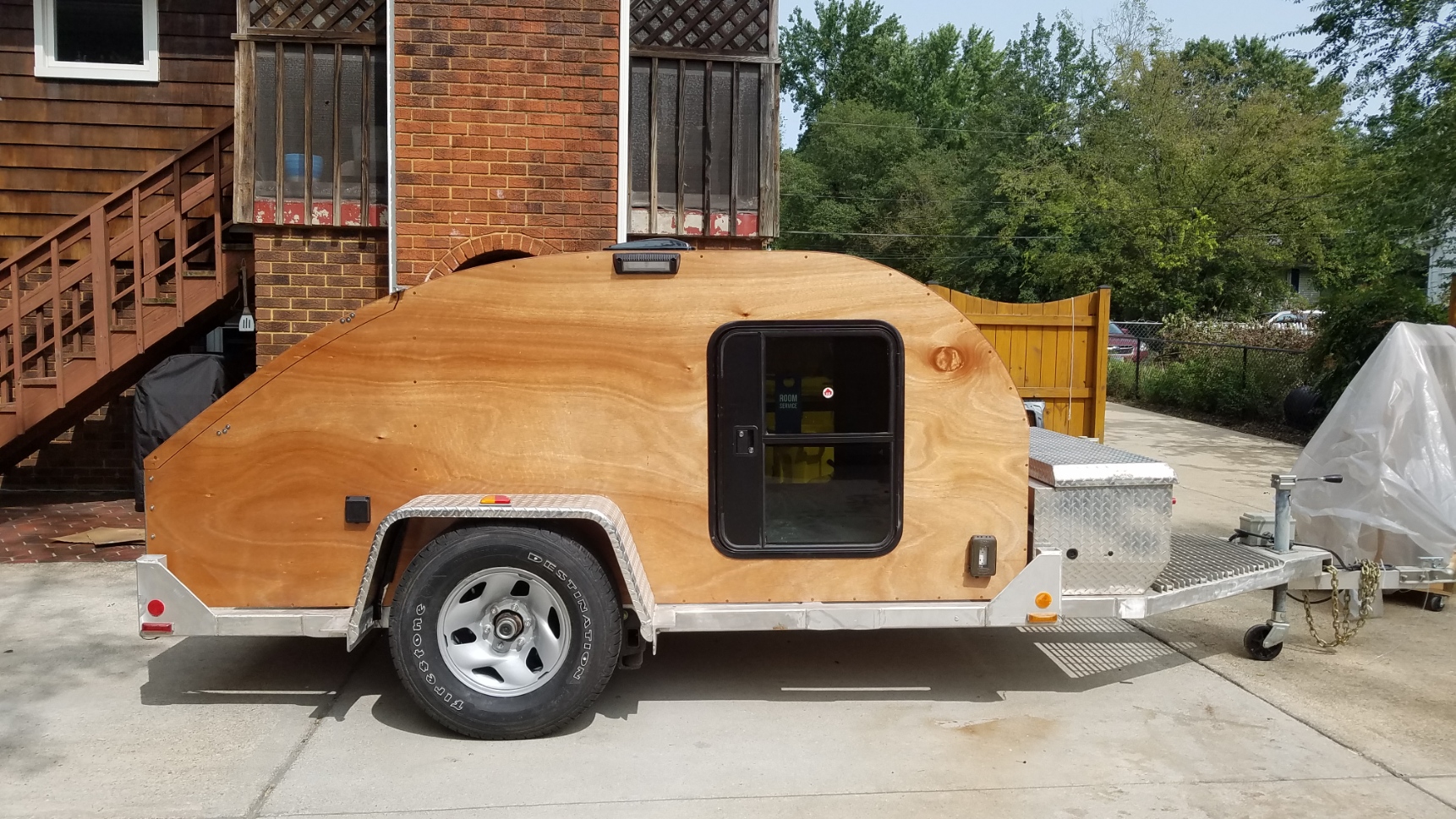

Postby rovwel » Tue Jul 06, 2021 8:38 am
Thiss is a profile shot of my 5x10 , very similar .
This is my 5 x 10 , similar style
