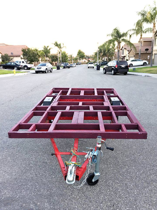

Postby Vtec44 » Wed Jan 15, 2020 11:04 pm
I built mine on a HF trailer but the opposite direction, with 1 foot extended out of the rectangular frame in the front and 2ft over on the back. If you extend the too much onto the A frame, it would decrease your turning radius and the house may hit the car during very tight turns. I thought about it during the planning phase and decided against it and extend the house on the back of the trailer instead.

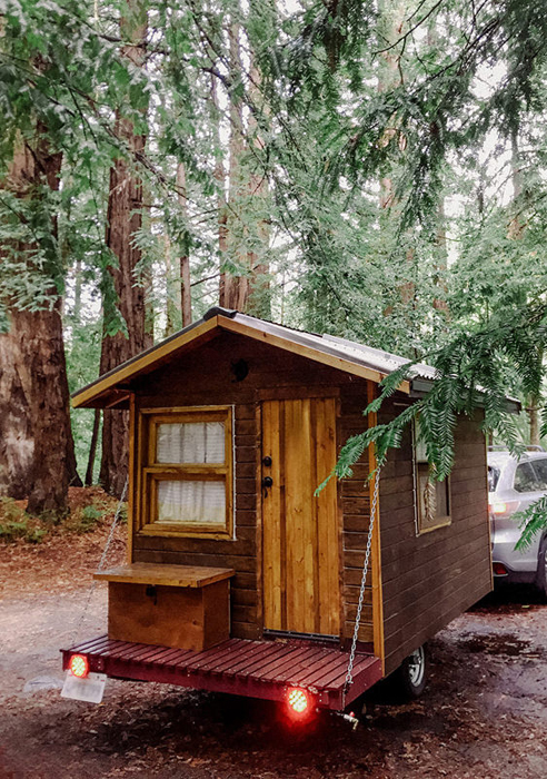

Postby Dan242 » Thu Jan 16, 2020 4:15 pm
Built mine on a HF 4x8, You will always wish for more room.... My sleeping area is 5x8 with a 2' by 5' V area up front for stuff. Small back porch with storage underneath. Image

Postby Vtec44 » Thu Jan 16, 2020 4:31 pm
Dan242 wrote:Built mine on a HF 4x8, You will always wish for more room.... My sleeping area is 5x8 with a 2' by 5' V area up front for stuff. Small back porch with storage underneath. Image
Very nice build @Dan242 . How long did that that take you?

Postby Dan242 » Thu Jan 16, 2020 4:37 pm
About a year, took several breaks during construction. Lived in it all summer last year while i remodeled our house
