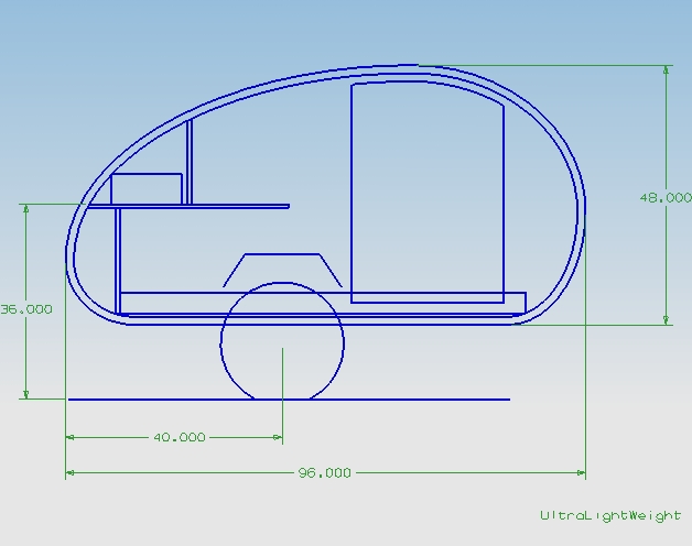

Postby mikeschn » Wed Feb 22, 2006 8:48 am
Okay, here's what I am thinking.
This is a shortened up version of the Modernistic. It'll get pine framing on the outside. The walls are 1/4" moisture resistant luan.
There's room in the galley for a stove. A little bit, (not much) storage under the counter.
I'm thinking a motorcycle battery under the counter. A single light in the galley, and a single light in the cabin.
1 shelf in the cabin.
My goal is to come in under 500#, with a tongue weight of 75#.
Oh yes, 48" wide...
Any more thoughts...?
P.S. Oh yes, no frame. We'll bolt the axle to the floor...
Postby toypusher » Wed Feb 22, 2006 9:06 am
Mike,
You could make the walls with 1/8" plywood inside and out with 1/4" foil-bubble-foil insulation. Of course you would need 1/4" framing between the skins.

Postby Chip » Wed Feb 22, 2006 9:35 am
Mike, what you have sketched is not too far from the new trailer,, the shape is somewhat reversed though,, meaning I have more slope in the front than the rear, this lets me use the area under the counter for storage and converter,, counter has a 2' wide lift up panel to access the under storage area,, a simple cabnet that can be accessed from cabin and galley,, I got to get it weighed but I am guessing 600 lbs empty and tongue weight is about 40 lbs,,, I got to load stuff in the cabin to give enough tongue weight for better pulling,,

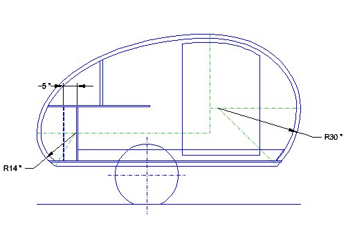

Postby angib » Wed Feb 22, 2006 6:08 pm
My thoughts:
Rounding the bottom edges at the front and back does lose quite a bit of space which, even in an ultralight, is still valuable. Also if you're not using a metal frame, having the front panel reach the bottom somewhere near the vertical (say, as upright as 45deg) makes it a better front support for the tongue.
If you're gonna say the Superleggera doesn't do this, I'd say: Yup, I now think it's wrong!
So my version would look something like this:
The extra 5" of galley space isn't all due to the shape - I've assumed I can cut the mattress foam at an angle as that gains me another 3" while still having a 75" long top surface of the mattress.
It is the vertical sides and ends of a teardrop body that provide the vertical strength - the floor is just a trampoline strung between the sides and ends. I have an idea for a wooden tongue too, though frankly I don't think it's worth the effort - but I'll try to work on that tomorrow jsut to start a decent argument!
Andrew
