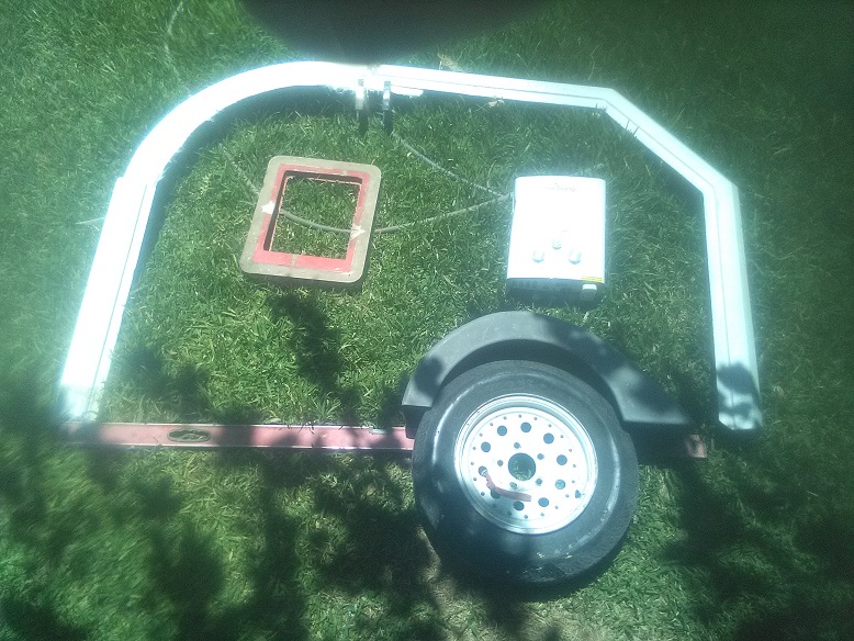

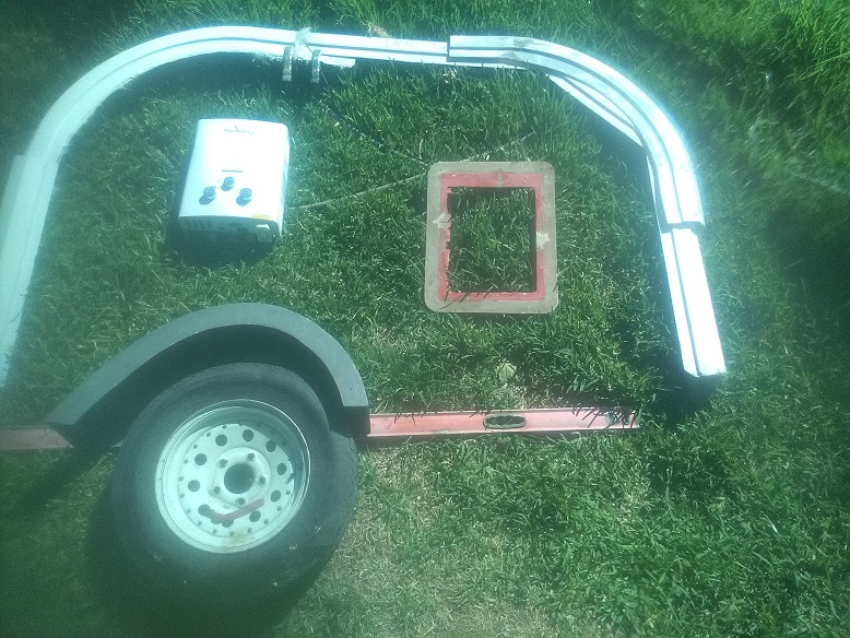

What do you think. Tiny minimalist sleeper/stand up. . The planning for a new trailtop fiberglass component trailer. Think Legos .Please any thoughts good bad post them. Some of the things I would like in this design. Light some aerodynamics on the back .Can be reversed in design Easley look at fender placement. So a cross of Clipper Express and Wild goose . A fold up. Opened so can set in side when weather goes bad. Can be folded down and still be slept in at no tents camping grounds. Also when it is cold. . Body heat. That could carry a canoe on top. no doors back opens like a tent. Have 3 different style going on. Should the round part be in back are front? can not makeup my mind.
. One more to think about rounded on the two corners. Neighbor is build a clamshell roof top tent using 4 rounded corners .Also a coffee kiosk .using 4 rounded corners

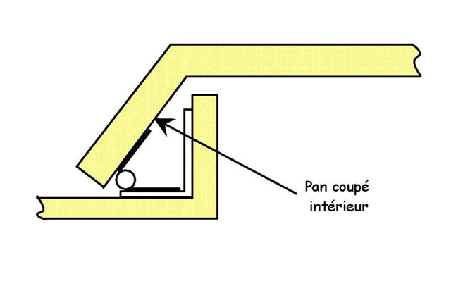

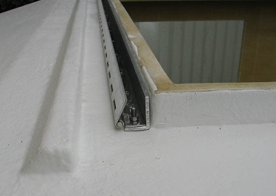

This is the hinge I will be placing on the back lifting roof . Cost less than hurricane hinge .Should not leak.

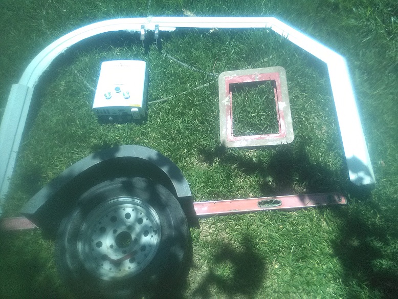

This is the profile I will be going with. To me the hardest part is with the lego parts. Is when you move them around they all look cool. Would like it to open like the picture. Do I cut for the lifting part? down the center are at the roof line

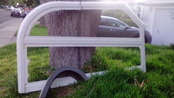

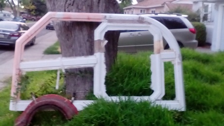

did not have the guts to do a clam-shell. So this is where I am today.

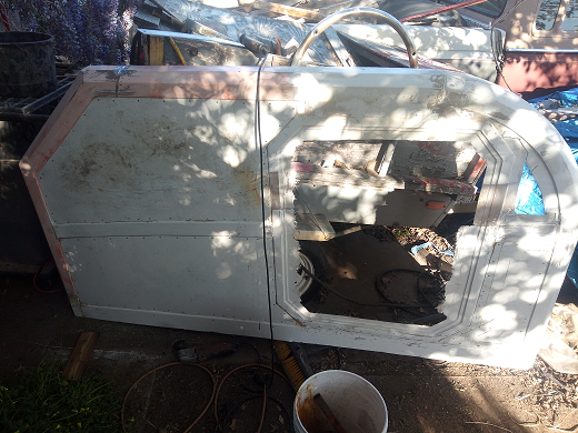

last Aug. shoved this frame into storage where it set no warping are rot . To put fiberglass skin on Go to the outside corners of resets drill 1/8'' hole . lay the skin on outside of frame .Go to inside find holes .Drill through the skin . Then connect the holes and cut . The reset in the round part will draw on clear vinyl then transfer Trailtop components style build
