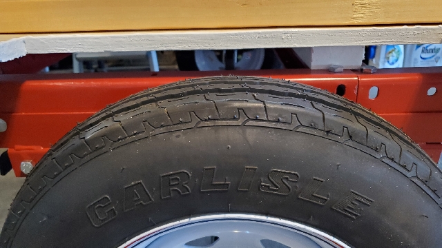

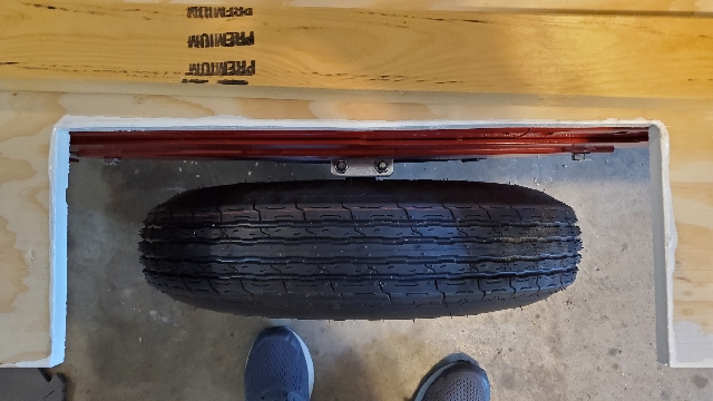

No worries there, the wells are very shallow and I should even be able to upsize the tires in the future. I plan on a pretty aggressive trim on the bottom edge but it will be flexible. Here are a few shots to illustrate the clearance. I expect a well at or near 1.5".
I am using the potential travel distance from the top of the axle to the bottom of the leaf mount as a guide.
