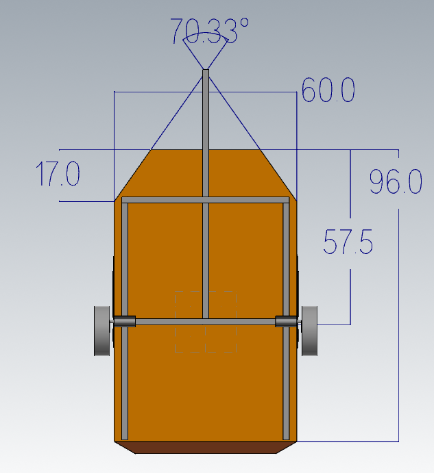

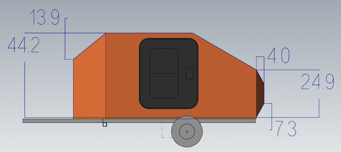

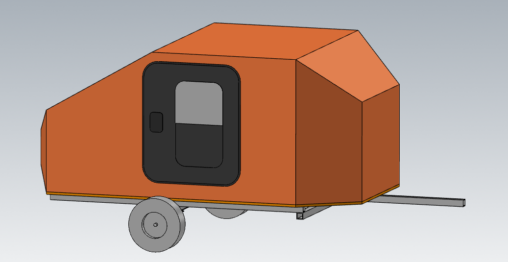

Hello, this is the design i'm currently working on for my tiny trailer, it's designed to hold a double/full sized mattress and my initial estimate is $2,000CAD/$1,600USD for all parts (before shipping and screws and bolts and other fiddly bits) and should weigh about 200lbs or a little more

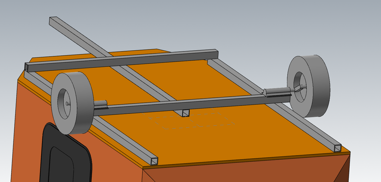

basic design uses 2x2x.125" aluminum square tube as the frame on top of torsion split axles and 8" wheels (to ensure the tounge weight is about right but the wheels don't interfere with the door, there will be fenders i just didn't model them)
that gets bolted onto a 1/2" 5x8 foot marine plywood floor (maybe I can use regular plywood and just seal it to save weight) with a shell made of 1.5" ridged foam that's reinforced with poor man's fiberglass (and maybe something on the inside that's ridged and light like thin wood paneling)
Doors are pre-made and just need to be popped right in https://www.teardroptrailerparts.com/doors.html
What are your thoughts on the basic design?
I'm not an engineer, but that seems awful light for the tongue. If it were steel, I'd say it was light but okay. It wouldn't take much to bend it.
Hopefully, someone with a bit of structural knowledge will chime in.

The long un-laterally-braced tongue that raises concern for me. Also might want "no step" signs on tongue.
Are you in a state where registering will require inspection?
QB

The tongue and the two parallel bars will be screwed to the wood flooring at 6 or 12 inch intervals which should secure it very well, the tongue might be slightly shorter so the coupler ball is right at the intersection of the two angle walls (to make backing up easier as you can tell if you are about to jacknife easily.)

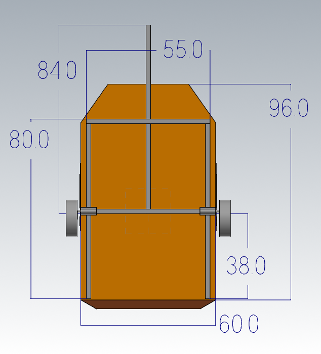

I thought the 84 was inches and looks like 48" of tongue unsupported. Just seems possible to bend right at point it is under cabin if you loaded it at all or stepped on it. I know its light and you won't put anything in it while towing, but pictures on this site of heftier steel tongues bending at that point.

yeah sorry it is in inches. Measuring in the program the lengths are 26" from edge of the shell to the tip of the bar and 42" from the tip to the cross beam, and I'll shorten it a little so the total length includes the coupling; but yeah I see your point. If i load the trailer correctly there should never be a lot of weight on the tongue (and the front jack will sit just beneath the floor on the tongue). I was doing my best to guess at what the bare minimum would be needed for the frame but I suppose I overshot a little and should switch back to .250" for the bars, might as well make them all .250", and yeah I can add a do not step warning to the tongue.

I'm generally the critic of over building, advocating strong enough, not just strongest. And the impact from a pothole bounce can be a multiple of the load. Test it. Clamp some two-by to the tube approximating the underfloor, and support at axel and hitch points and jump on it.

I wish the design resources included a very simple frame that imho would suit your intents better. Basically a triangle. Instead of a center piece and two parallel at side, a triangle with axel as base and hitch as apex. The "corners" just hang over diagonals. Actually less material and more rigid.

i mean, i did see that, but the angles that tongue hitches come in is somewhat limited, and the front corners and entire back half of the trailer would be unsupported - and i don't trust 1/2" plywood or even 3/4" plywood that much. the designs I saw using the triangle also had a frame of parallel bars running under the body which makes the weight saving a smidge moot.

Build deck of 1/4" ply on 1 or 1 1/2" foam. Roughly as strong as two-by and weight like 1/2" ply.
The frame I recall was just triangle and axel was the base. I really miss that collection of designs.
In my design work if using aluminium its generally larger than steel by half or more - 3" instead of 2" - for portable staging for instance. Don't use it often as generally triple the price for half the weight.
