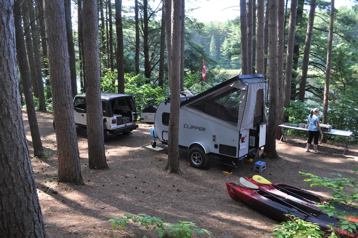

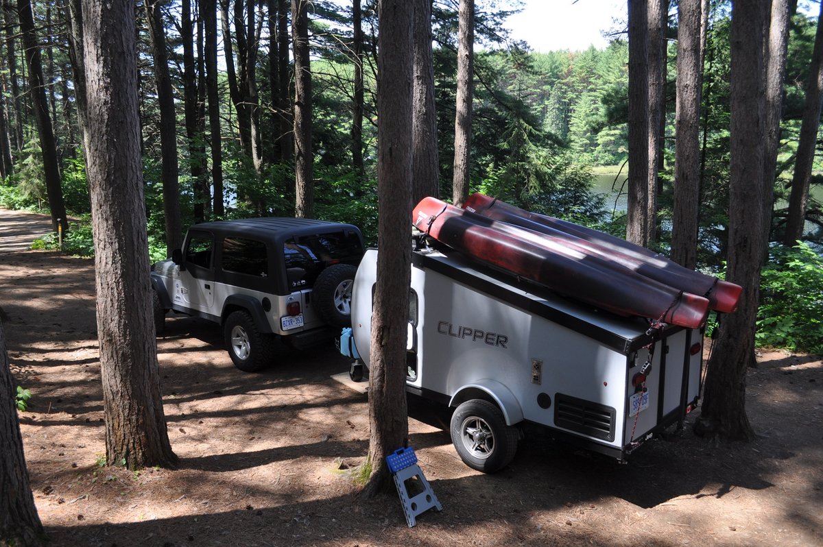

I have a pop up that's a bit like what you're thinking of. It's taller and allows us to stand up in most of it. One of the reasons for buying it was that we wanted to transport kayaks on the top. I built a rack for it that is easy to load and works well. Neither it or the kayaks touch the pop up lid so there's no weight bearing on it at all. It has soft sides though so it might be a no go for you.
