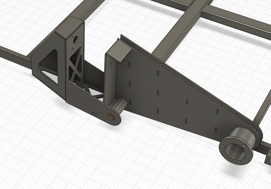

I started the job of designing the airbag based suspension system that would give us enough travel. I came up with a 2:1 ratio system that maximizes wheel travel. We would be able to run from 0-15" of ground clearance. Attached is the render of the basic design.
trailer suspension assy.png (436.93 KiB) Viewed 2282 times

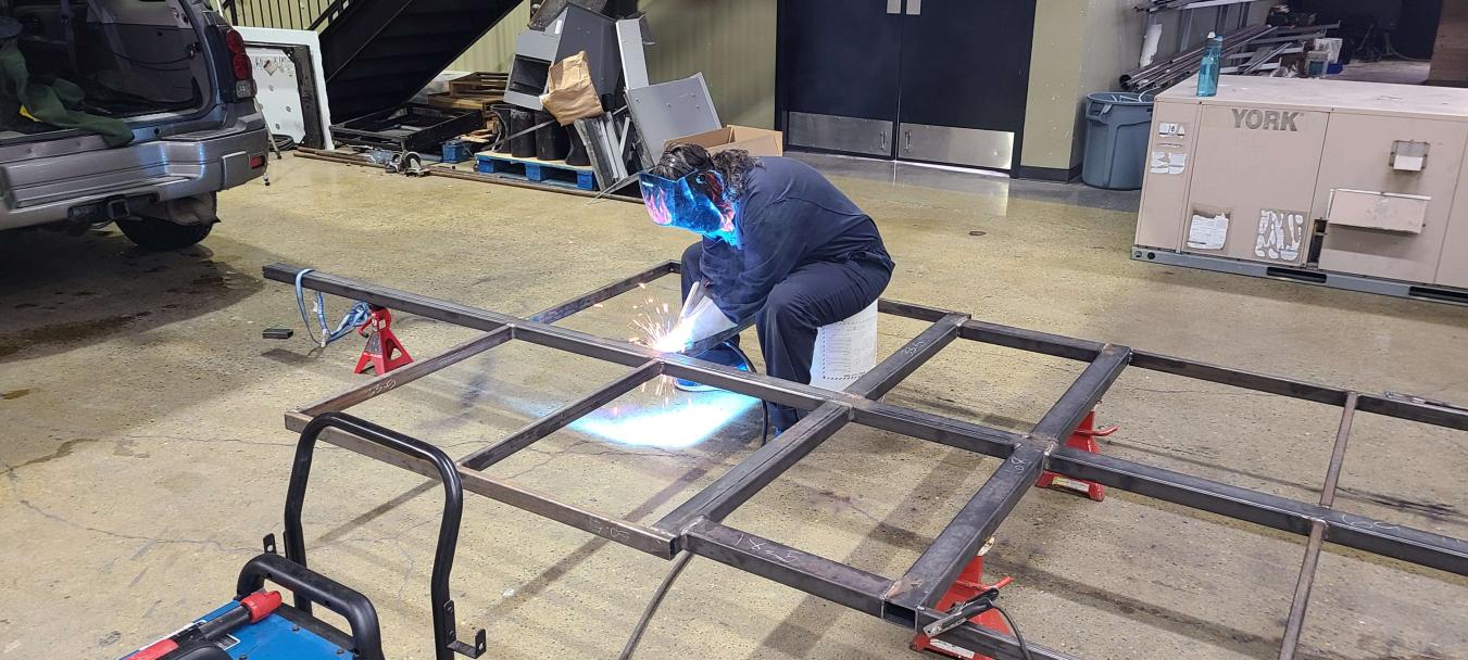

My wonderful wife welded up the bulk of the frame after we aligned and tacked everything.
Plum welding frame.jpg (158.39 KiB) Viewed 2282 times

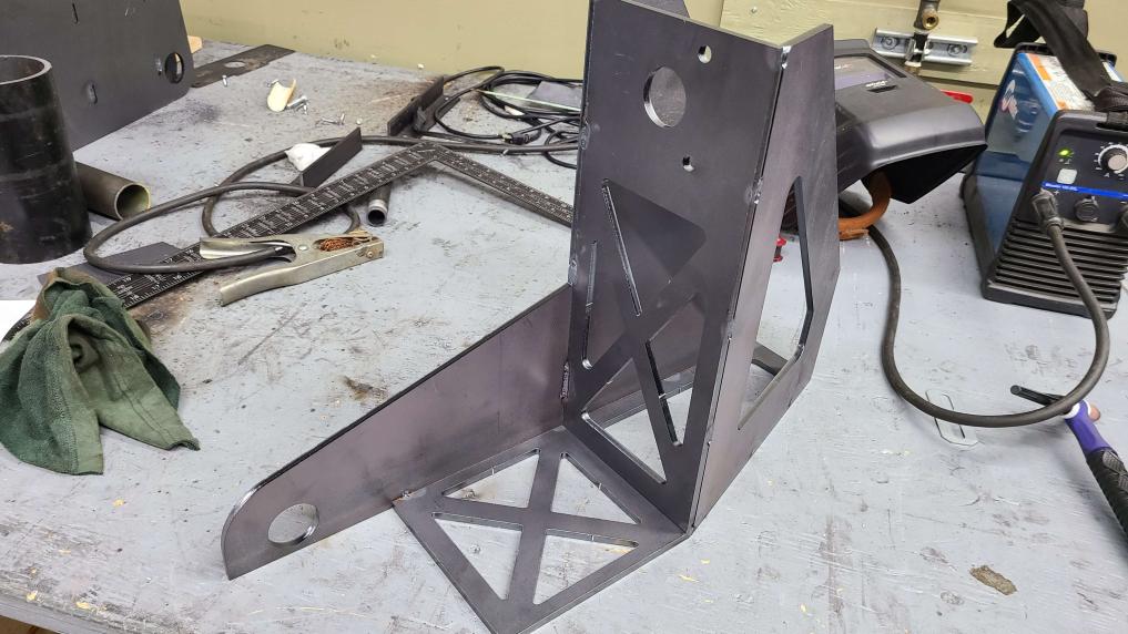

I worked on tacking up and aligning the boxes that would take the forces of the airbags as they suspended the trailer frame.
Suspension tacking.jpg (94.1 KiB) Viewed 2282 times

I don't consider those Compromise! You made a list of needs, then wants and balanced through reality. Though in my world sending spec's out to be laser cut is not a reality...
Air suspension is a different angle. Maybe I missed the why and would like to understand. Adjustable clearance? Curious why over torsion.
Looking forward to more of the build!
