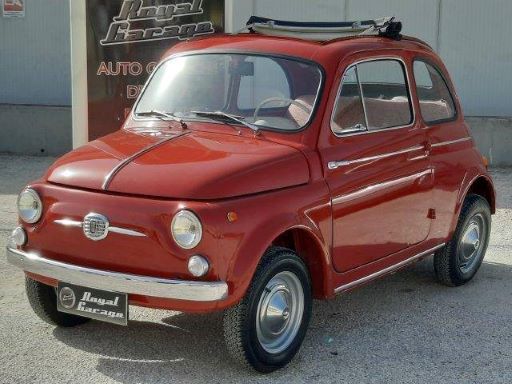

1963_FIAT_500_red - reduced.jpg (44.71 KiB) Viewed 2262 times
A 1963 FIAT 500 D

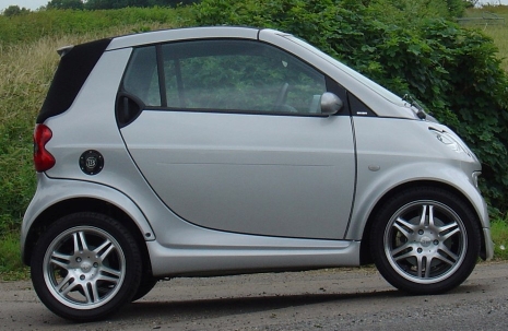

2004_smart_fortwo_silver - reduced.jpg (123.22 KiB) Viewed 2263 times
A 2004 smart fortwo convertible

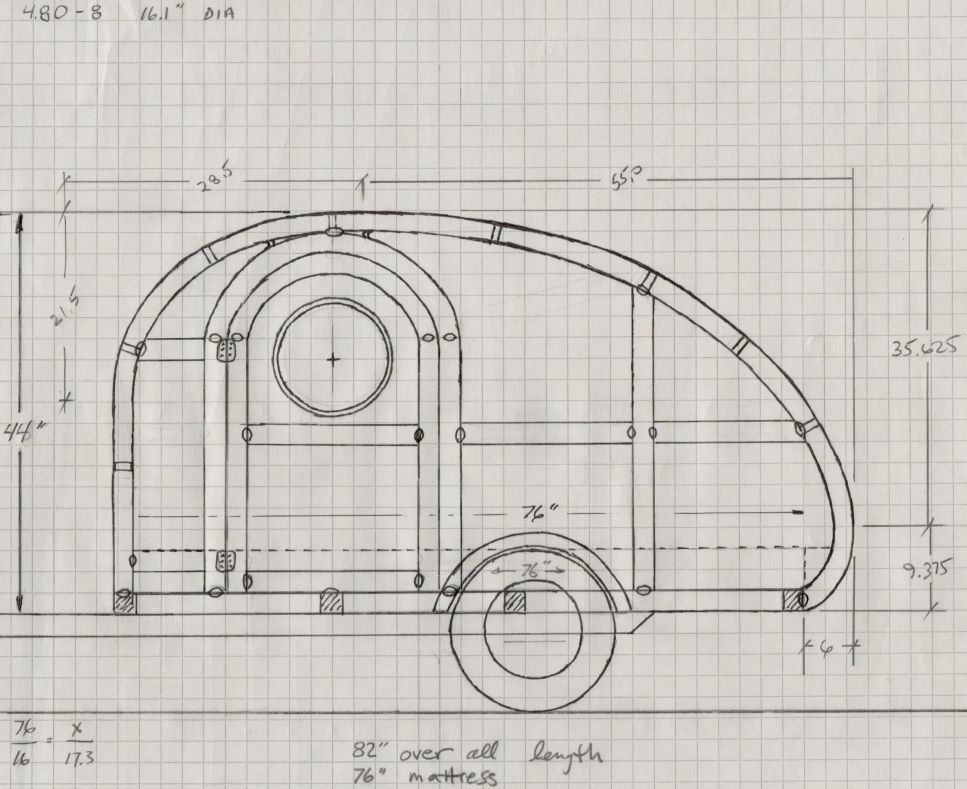

This is the initial notional layout - evolving and subject to change
I initially laid it out with 8 in. tires, but I'm leaning toward the 12 inch tires as that is the tire size on the FIAT 500 (125/12).
Note at the front of the trailer the front wall goes straight down. Aesthetically, it's a slight compromise (IMO), but the distance to the ball is reduced, which lowers the stress on the tongue.

After reading your chassis thread, I'm surprised your sketch suggests so much framing. Thin ply well adhered to foam or honeycomb - stressed skin panels - should just about eliminate framing and a lot of weight.
Looking forward to this one.
QB

Postby pchast » Sat Apr 22, 2023 8:49 pm
I agree. I think beyond framing in the base you really only need extra support for the door, hinges and latch, and the vent fan. I used more structure than I needed. It was my first time working with foam. What wood I used was mostly western red cedar (extremely light).
The curve of the roof creates a stress that provides a good deal of structure. As always testing and experimentation
is recommended.

Postby kennyrayandersen » Sat Apr 22, 2023 11:31 pm
pchast wrote:I agree. I think beyond framing in the base you really only need extra support for the door, hinges and latch, and the vent fan. I used more structure than I needed. It was my first time working with foam. What wood I used was mostly western red cedar (extremely light).
is recommended.
QueticoBill wrote:After reading your chassis thread, I'm surprised your sketch suggests so much framing. Thin ply well adhered to foam or honeycomb - stressed skin panels - should just about eliminate framing and a lot of weight.
Both your points are well-taken and the feed back is appreciated. The sketch is just that at this point -- a sketch. As long as there is a good connection between the walls and the floor, and the floor is attached well to the frame, there isn't much cabin framing that should be needed. I think at the door (for hinges and latches), it would be nice to have something for the screws/bolts to attach to. Depending on material selection most of the framing should disappear, or at least be greatly reduced.
