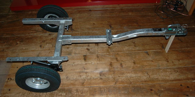

Postby Spardo » Sat Jun 08, 2013 7:20 am
Went down to Perigueux yesterday to pass on a request from the insurance legal people that the trailer man who has the wreckage write an appraisal of the damage and what, in his opinion, caused the failure. I must admit I don't have much faith in this legal department, the only reason I involved them over a week ago was because I wanted a recommendation for an independant expert. Now, all they have done is ask me to ask a, not independant, expert to comment. Going round in circles it seems.
While there though I took this picture of the VIN plate. The chassis number is not clear because yet another AVI clown popped a rivet through it. At first I thought it was 001 and thus maybe even an experimental one. :shock: On looking again it seems more like 11-, so anywhere between 2 and 10 before yours Phil.
I also took the opportunity of snapping (possibly not the best colloquialism :roll: ) the jockey wheel. This because they had half accused me of not securing it and that it had dropped to the road thus ripping off the A-frame. I think that this demonstrates ably that it wasn't the case.
I will wait to see what the trailer man reports but am almost decided now that I will give AVI 14 days to agree in writing to re-mounting on a new chassis here. Failing that I will go ahead anyway and sue them in England for reimbursement of all my costs. I am determined that they will not get the existing vehicle back to tamper with and I certainly don't want a replacement from that factory.

Postby Penfold » Mon Jun 10, 2013 3:57 pm
Spardo wrote:Went down to Perigueux yesterday to pass on a request from the insurance legal people that the trailer man who has the wreckage write an appraisal of the damage and what, in his opinion, caused the failure. I must admit I don't have much faith in this legal department, the only reason I involved them over a week ago was because I wanted a recommendation for an independant expert. Now, all they have done is ask me to ask a, not independant, expert to comment. Going round in circles it seems.
By the way, the intransigent individual that I have been dealing with and who I was led to believe was a director is not in fact listed as such after a company search. In fact the most senior director appears to be the man that I first spoke to on the phone to order, so it will now be to him personally that I will direct my letter.
That welding looks shocking!
Penfold
