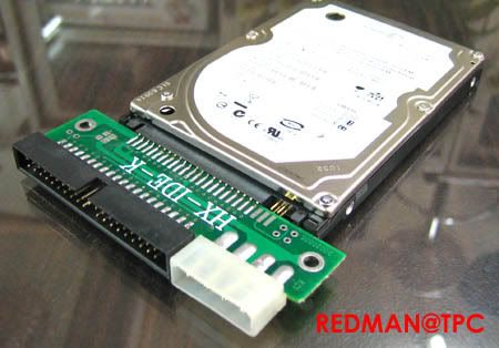

Postby asianflava » Tue Jan 22, 2008 3:41 pm
I used a 3.5 to 2.5 IDE converter when I had to image my laptop's HD, it's only a couple bucks. Basically it allows you to plug your laptop's HD into your desktop. It allows full functionality at full speed.
You can do it with a USB enclosure but it takes a lot longer to do. When dealing with large HDs you want all the speed it can muster. I imaged a 100G HD and it still took a couple hours.
