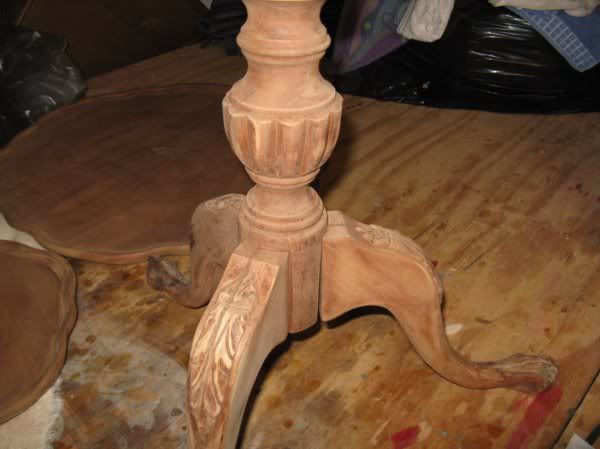

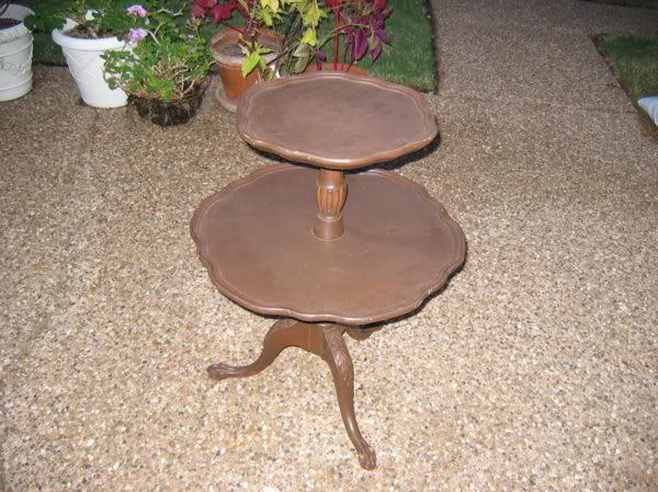

To all the furniture re-finishers out there I have a question. My wife saw this little table at a flea market and just had to have it. The price was right so we bought it. It sat in the garage while I built my tear but now the tear is finished I needed a project. I stripped the finish off the table and have sanded it down. I have no idea what finish to apply. The tops of the two discs are a nice veneer but the edges so the upper and lower veneers and the cheap wood in between. Also the finish did not all come off so there are dark and light spots in the wood. I would like to have it be a wood look but a regular stain would show the aforementioned blemishes.
Any ideas?

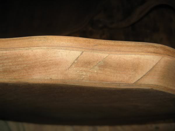

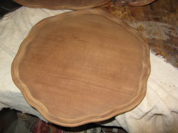

Postby planovet » Tue Apr 20, 2010 10:32 am
Thanks Danny.
Well, I did get all the old finish off the table. I used a dental instrument in the detailed areas but it's all off. What I meant was after sanding there are still light and dark areas in the wood from the previous stain/finish. Now I could keep sanding until I get all the wood the same color but then I would have uneven areas on the legs and such. And to be honest, I don't want to put that much work into it. It's not going to be a show piece, I just want it to look decent. And no matter how much I sand a regular stain would show the veneer layers and wood differences on the sides of the discs.
I've never used an opaque stain before, would that work or are there better options to keep the wood look? :thinking:

Postby halfdome, Danny » Tue Apr 20, 2010 10:39 am
Mark, I too have dental picks in my tool box for that same reason :thumbsup: . I always use stain that has a lacquer thinner base to it as it behaves the way I want it to. I can use it to touch up light areas between coats of cured lacquer to even out the finish. :D Danny

Postby 48Rob » Tue Apr 20, 2010 12:37 pm
Mark,
I'm no expert either...
Danny covered it pretty well. :thumbsup:
Sanding sealer will help on some parts of the table to even out the absorption of the stain.
Many furniture makers use cheap wood, with veneer on the most seen/used surfaces, and "cheat" by using a heavily pigmented finish to blend all the irregularities into an acceptable overall finish.
Stain and clear finish is generally reserved for higher quality pieces.
"Color matching" is what most refinishing work of the type you're doing amounts to.

Postby goldcoop » Tue Apr 20, 2010 4:47 pm
Mark-
Ditto on Danny & Rob's accessment.
The sanding sealer as a base, I find the gel type stains work well to work out the light-dark areas with a rag. Followed by a thinned down sealer on top of this. You can go back & adjust color with the same stain after it's sealed. Top coat.
Light sanding/tack cloth between sanding sealer/sealer/top coat layers.
Allow AMPLE drying time between all steps.
Make SURE all materials used are COMPATIBLE with one another.
Any dark areas in nooks & crannies will look like the patina of wax build up over the years...

Postby caseydog » Tue Apr 20, 2010 5:43 pm
With that blotchiness, you'll want to use a pre-stain treatment. That kind of wets the wood and makes it take stain evenly.
I would use a pretty dark stain, and leave it on a while to go for a dark color. That will hide the cheap wood and you should have less noticeable differences in color. A dark stain will also look more like an antique patina, too.
I have a bunch of antiques in my home, but I didn't take them that far down to refinish them. I wanted to keep the old patina, so I just sanded to smooth out the original varnish, stained my scratches to blend in, and did a few coats of modern polyurethane finish.
When you get into the color of the wood, you make it harder to get a nice even look. And remember, an antique piece of furniture shouldn't look new.

Postby 48Rob » Wed Apr 21, 2010 6:11 am
Gus,
Everyone’s vote counts! :)
While I agree that lighter stains/hues are a better choice for nice pieces of wood, the problem facing Mark is that he doesn't have the same finishing options as one would if they were starting with a high quality piece.
The piece he has is/was made of cheap, blemished wood.
Some of the pieces that make up the table are light colored; some are dark, and some in between.
It is easy enough to make lighter colors darker, but much harder to make darker colors lighter.
It can be done to some degree by bleaching, but it is nearly impossible to bleach a blotchy piece of wood to a condition that one could call "even".
The furniture manufacturers have perfected the art of color matching with stains and heavily pigmented top coats, to blend all the pieces with their imperfections into something the consumer is willing to accept.

Postby planovet » Wed Apr 21, 2010 8:40 am
48Rob wrote: Everyone’s vote counts!
Bingo!
It's a cheap piece and I just want to make it look decent. Even if I could lighten it up I still would have the layers of veneer exposed on the edges of the tabletops. I don't want to paint it and I want it to retain a wood look. I'm going to clean it up the best I can and try a darker stain to cover up the blemishes. It won't be perfect but neither is what I'm starting with.
